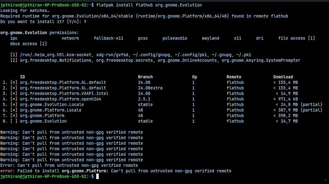

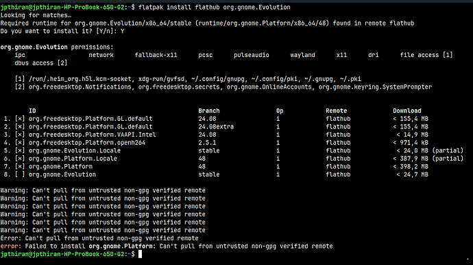

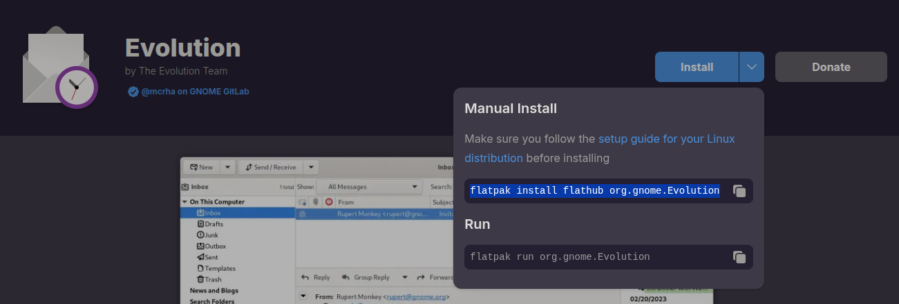

I removed Evolution and looked for the app on the site as follows:
and got the following error message:
error: Failed to install org.gnome.Platform: Can't pull from untrusted non-gpg verified remote
what should I do ?
thank you and regards.
Try;
flatpak update
then try again.

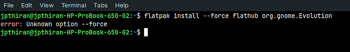

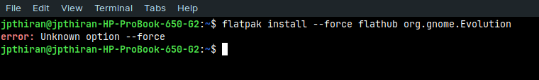

Try add the flag --force to the command.
flatpak install --force flathub org.gnome.Evolution
[quote="Storm, post:6, topic:48304"]
[/quote
I got this now:
error: Unknown option --force
I made the downloads from this page:

But you can switch to flatpak in the software store, so you don't need to use commands.

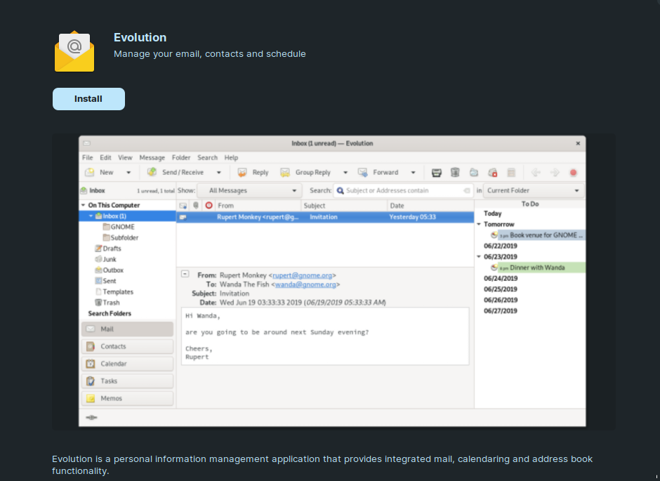

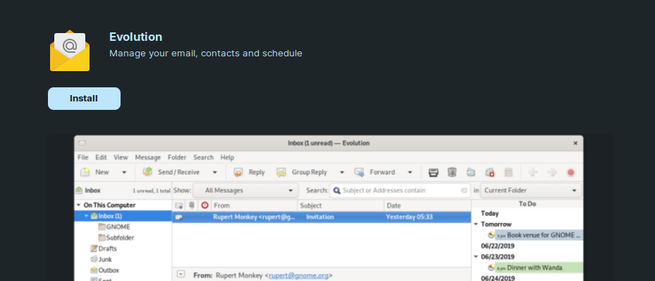

simply the looks that I get when I install the app is quite different from what we see on the image ...
how do I do that ? that is what I see - no options
Strange, it may be somewhere. I'm not on Zorin OS (I'm using a different Linux distro). Perhaps someone with Zorin can point where the switch is.
