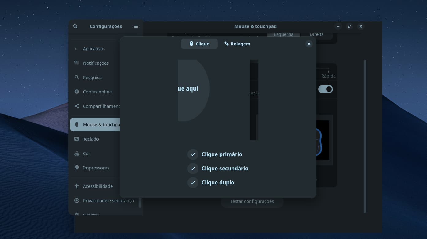

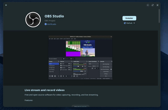

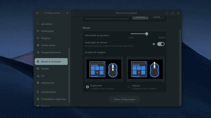

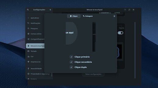

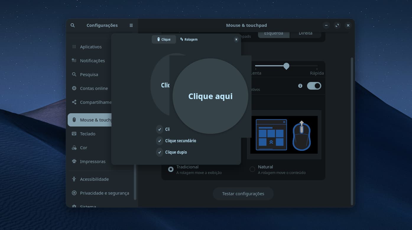

Since I started using Zorin OS on my workstation, I have noticed specific graphical glitches:
  • Location: "Settings" panels, file selection menus, and various list options (e.g., Search, Accessibility).
  • Behavior: Toggle switches and dropdown menus exhibit strange shadowing, element duplication (ghosting), or failures in border rendering.
  • Observation: The problem appears to be restricted to elements of the OS's native interface or GTK-based GNOME components.

Gravação de tela de 2026-04-15 11-43-40
Gravação de tela de 2026-04-08 14-47-06
