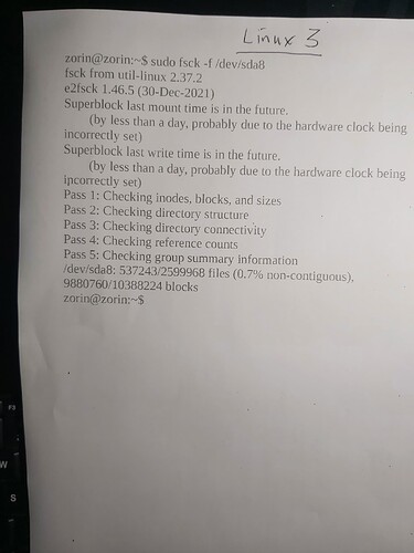

Now I cannot boot up Zorin on the laptop. I have tried the usual remedy with recovery boot option, fsck, grub repair, to no avail. The Zorin install starts with the "Z", then goes to the "ZORIN" the quickly disappears into the never-ending grey screen.

I had full screen visual of the RescueZilla program on the laptop, so was able to shutdown on completion of the image backup properly. I do not know if it is a coincidence that it has happened after both machines had the RescueZilla system image backups or not? The Windows10 boots up normally. I did some work on it yesterday which I will attach (mobile camera image).
