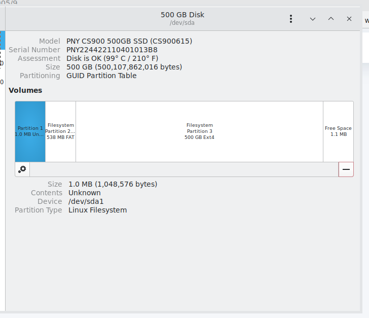

You can run gparted in a USB Live Session of Zorin and post a screenshot of your partitions here if you still need help.

In gparted you can also see the mount points. Look in gparted if sda2 has a boot flag (/boot) and sda3 a root flag (/).
If you need to use e2fsck it is best done using Kali Linux in live (try) mode.
SMART status in BIOS is OK.
sda2 has a flag = boot, esp
sda3 has no flag.

When you boot from Zorin Live USB Stick can you run gparted, right click on sda3 and choose "manage flags" to set / (root) here? But I am not sure if it will remain after reboot without the stick...

Please forget my suggestion. It does not work. I am sorry. I could only try it now on my PC. There is no possibility to set a root flag in the live session in gparted.
