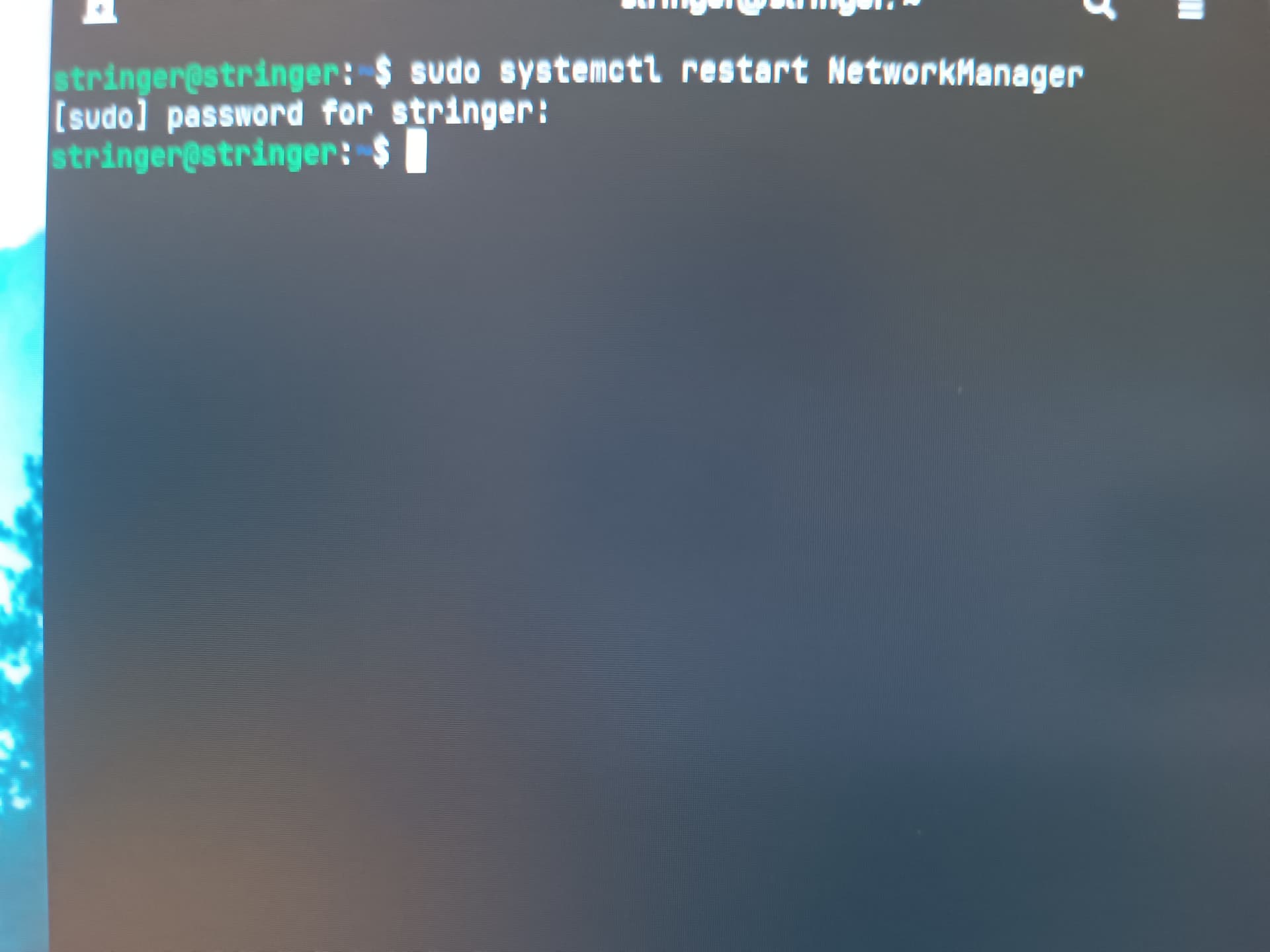

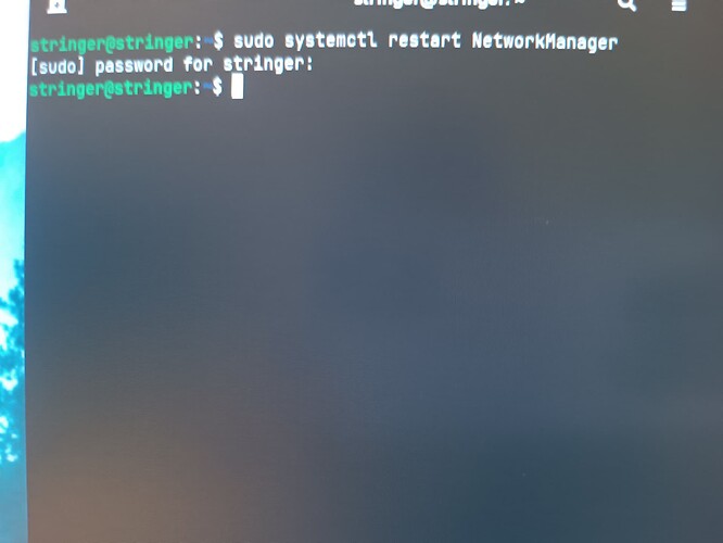

Check if Ethernet is working.
It's not working , i restarted pc and entered recovery mod and still nothing has changed

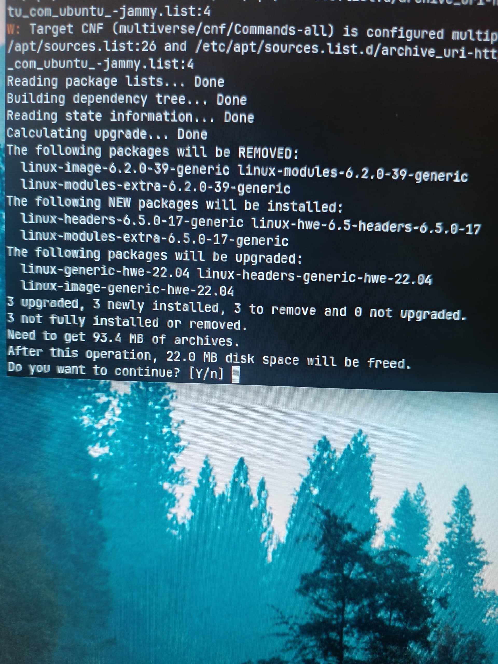

It looks like you had trouble when installing Nvidia on the 6.5 kernel.
So let's first try the 6.2.0-39 kernel - non-recovery
Once you reach the desktop, check if internet is working.

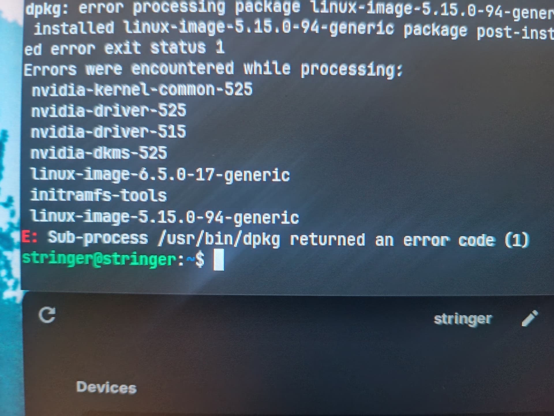

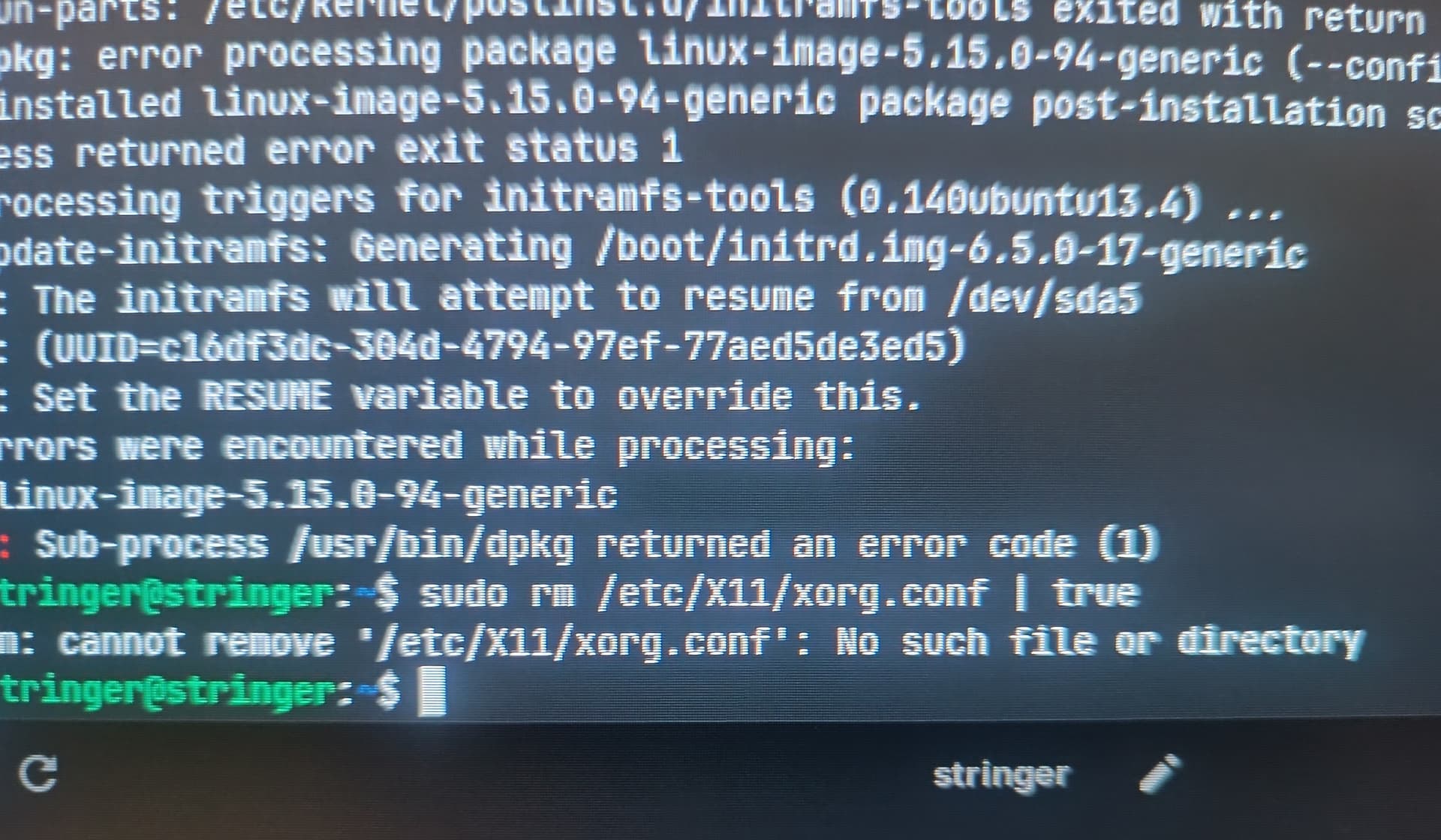

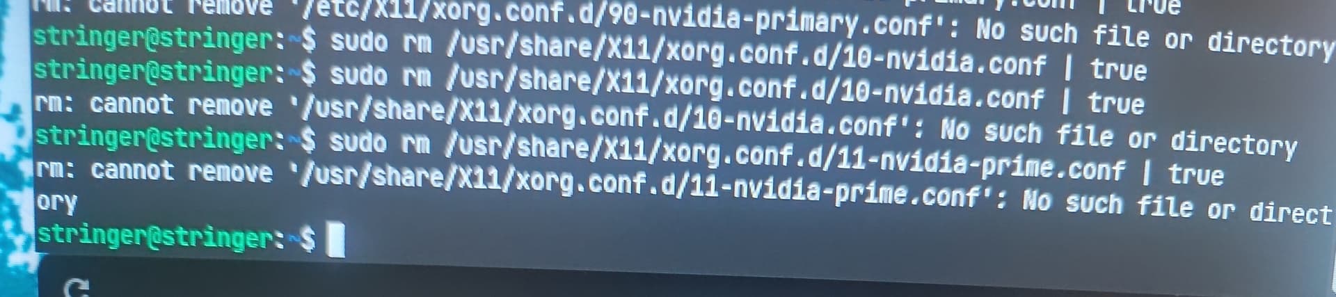

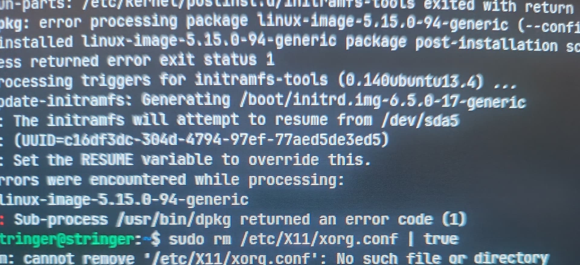

After i write all the codes here is the pictures , it is weird i have the E : massage after every code i type
An error is a stopping point. If you have an error, the command has failed.
Each following command should only be run if there were no errors.
Let's start at
sudo apt --fix-broken install
and relay the terminal output.

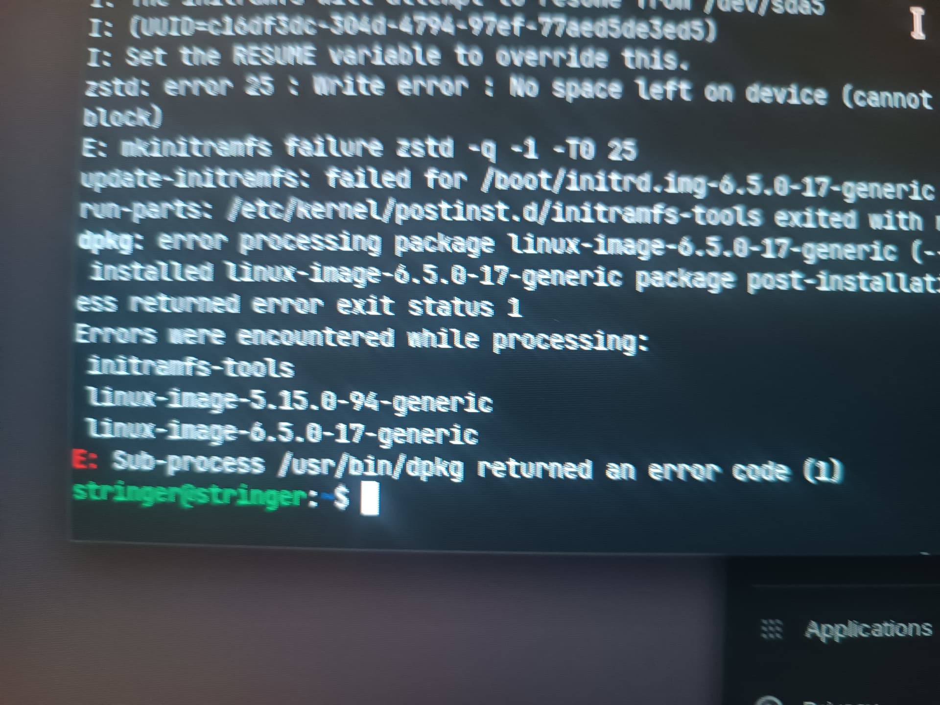

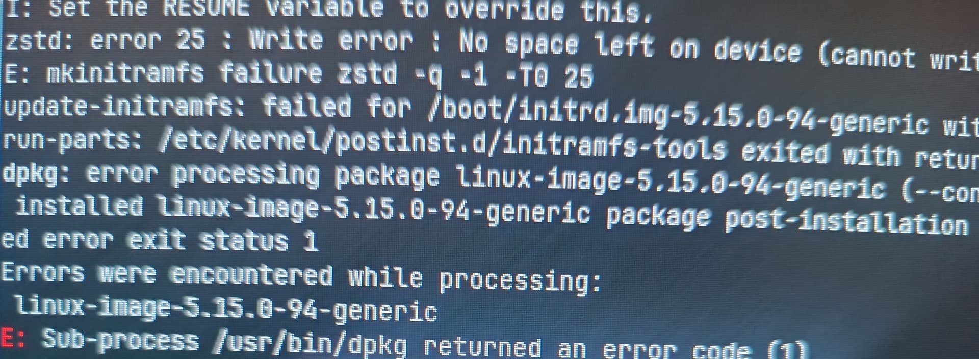

I cannot see the full output.
I do see a line saying that there is no room left on the drive. Is your hard drive full?
That would explain all the issues...
The screenshot of your drive shows that /boot is almost completely filled.
You can clean out some space by removing old kernels.
You can *check what is there with
ls -l /boot
