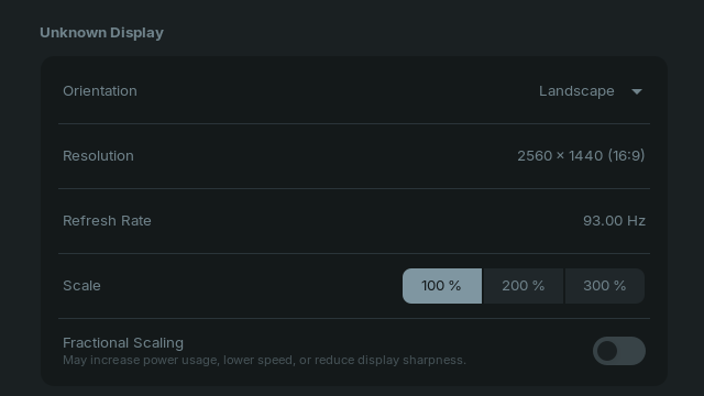

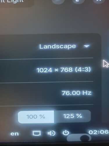

93hz is supposed to be 165hz , and there is supposed to be more options for both resolution and refresh rate
Screenshot from 2024-02-07 04-10-03

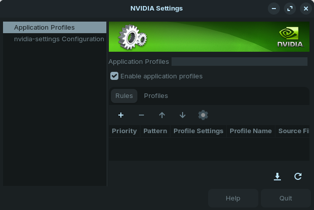

and the other one is about nvidia
Screenshot from 2024-02-07 04-10-33
i don't think i have to explain this one :sweat_smile:

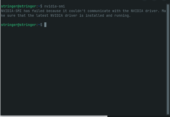

reboot and test:

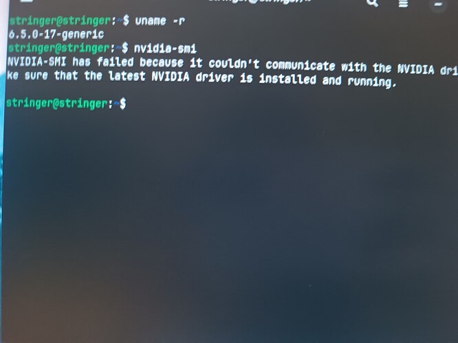

nvidia-smi
Screenshot from 2024-02-07 15-19-38

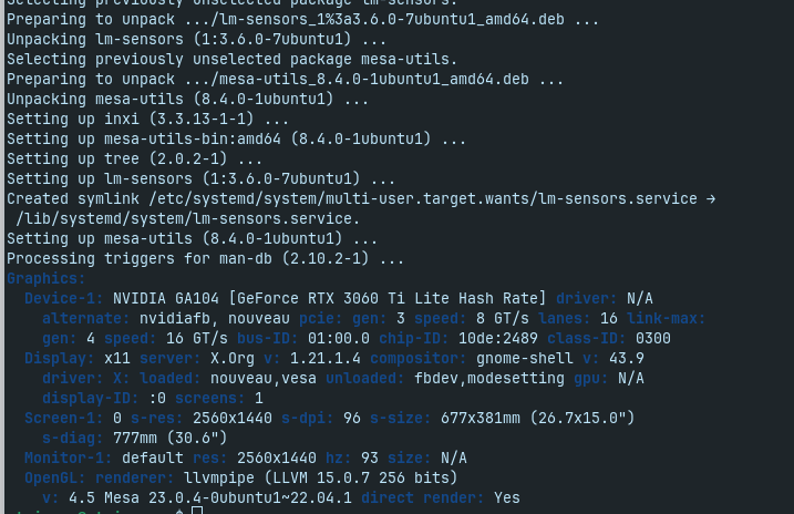

What Nvidia card are you using?
Easiest way to figure out which card and driver in use:
sudo apt install inxi
inxi -Ga
Please post the output.
3060 ti , when i played ( the finals ) couldn't find my nvidia gpu , and now i can't play any game on steam .
Hmmm... I have RTX3060...
Currently, I am using the 545 Nvidia driver.

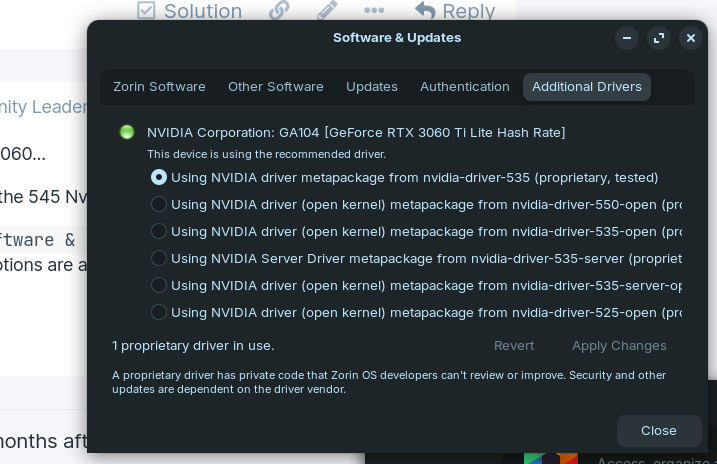

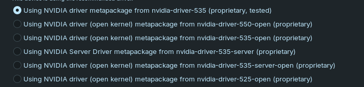

When you look in Software & Updates > Additional Drivers, what is listed as in use and what options are also listed?
Can you please try the 525 (Proprietary) or 535 (Proprietary). The (Proprietary Tested) versions can be a little bit odd, sometimes.
is it okay if i download 550 driver instead of 535
and is the number important or not ?
Yes, I did the same and upgraded to the 545 due to the 535 being buggy and the 525 not practicing proper thermoregulation.
The number is the driver version release number with higher numbers being newer.
For a 3060, you will be able to employ the newest available Nvidia drivers for quite a while.

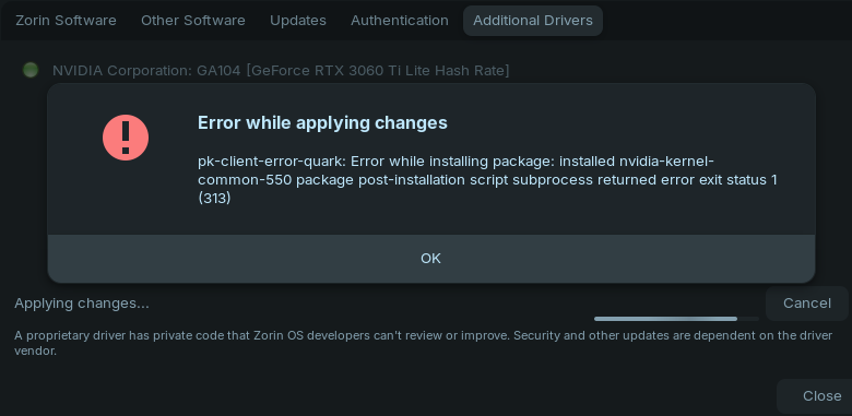

the download is in progress but i received this error what should i do

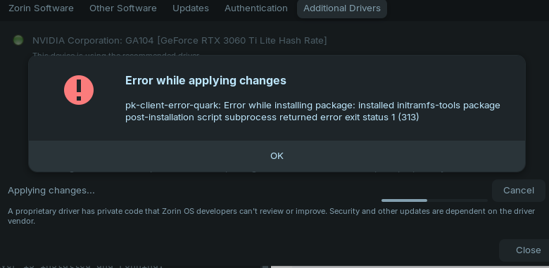

here comes another one

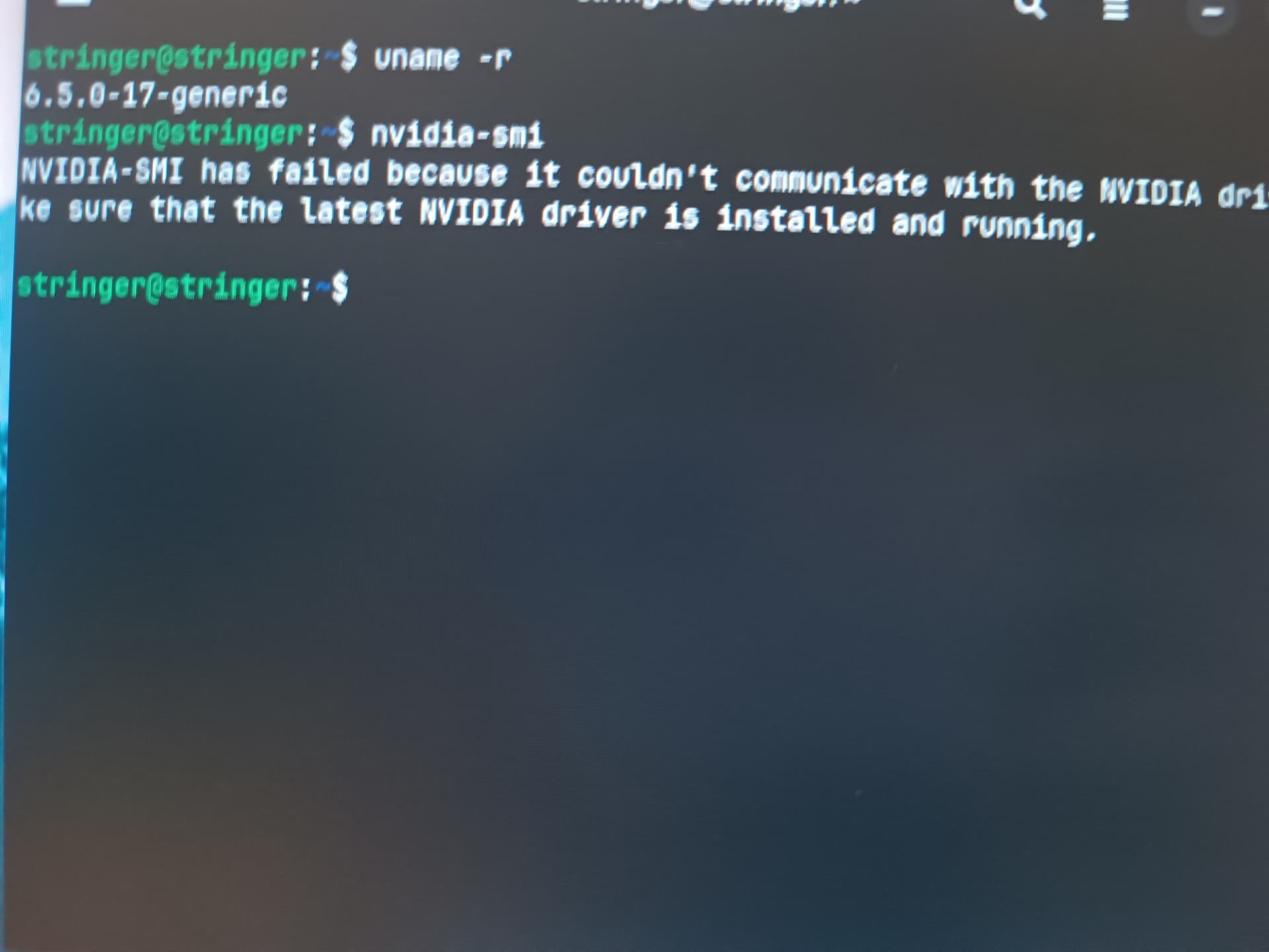

Which kernel are you on?
uname -r

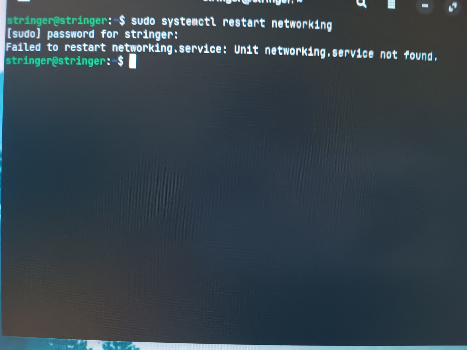

After i downloaded 550 and restarted pc i can't connect my pc with ethernet
See if running
sudo systemctl restart networking
gets the internet working again...
Don't get me wrong, installing the Nvidia driver should not disable internet.
It is also odd that a 3060 would fail to comminicate with nvidia-smi using any of the drivers 525, 535, or 550...
Is your nvidia card functioning? Do the fans on it spin?
How did this happen ?
Sorry, try
sudo systemctl restart NetworkManager
