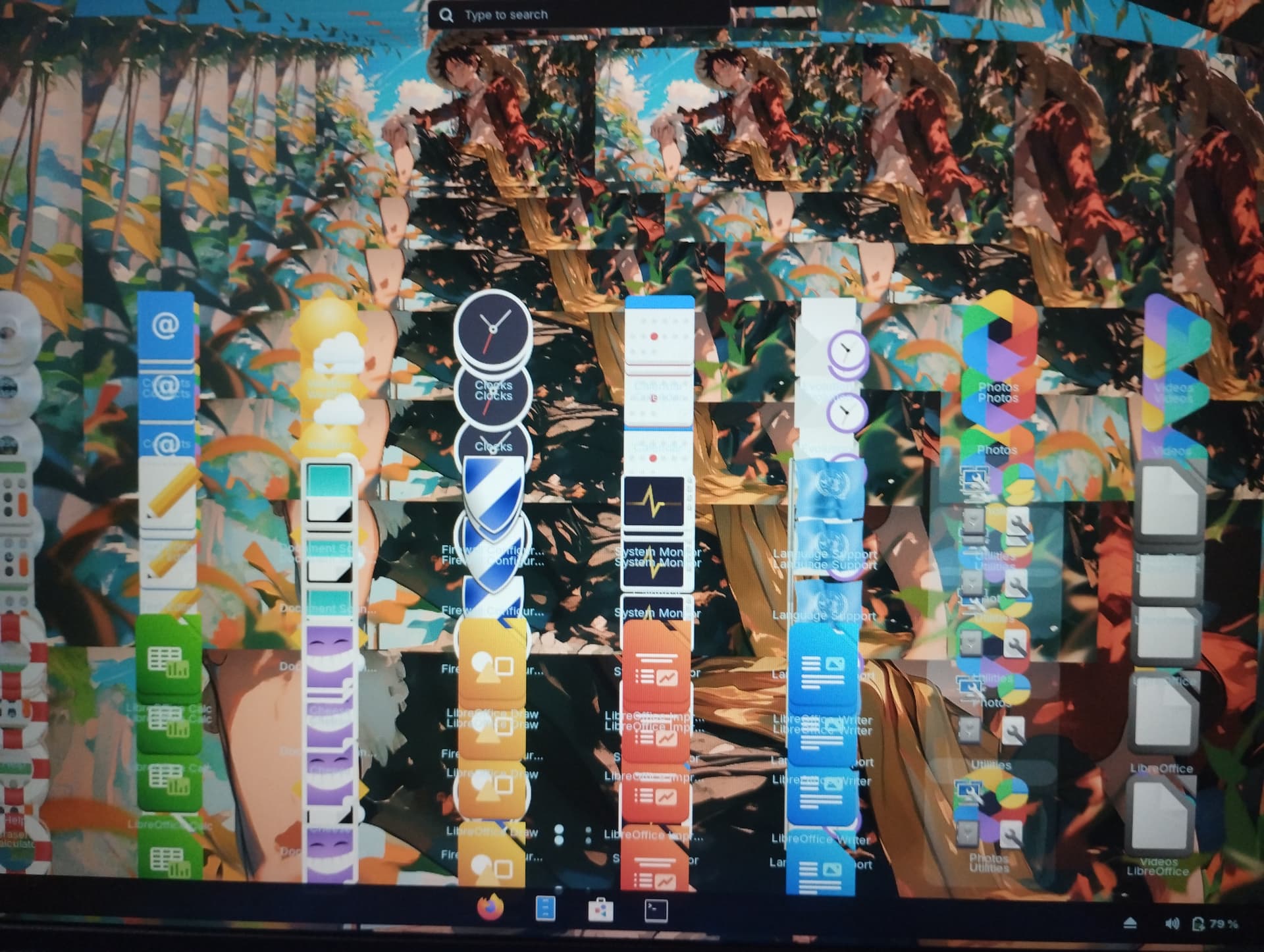

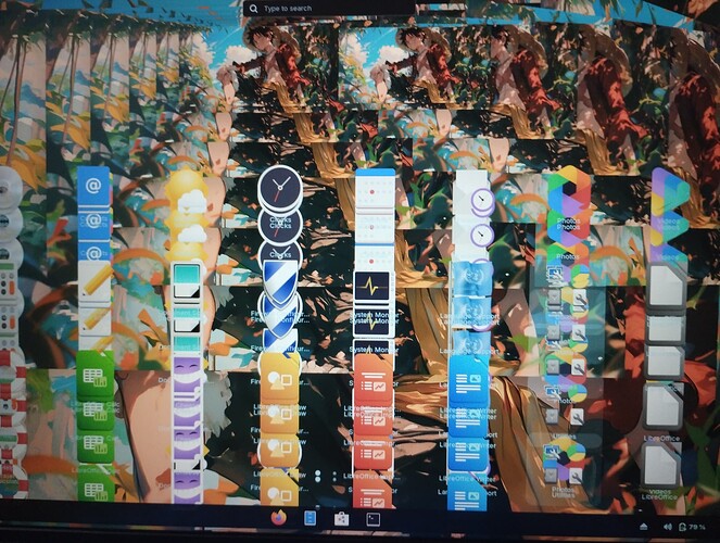

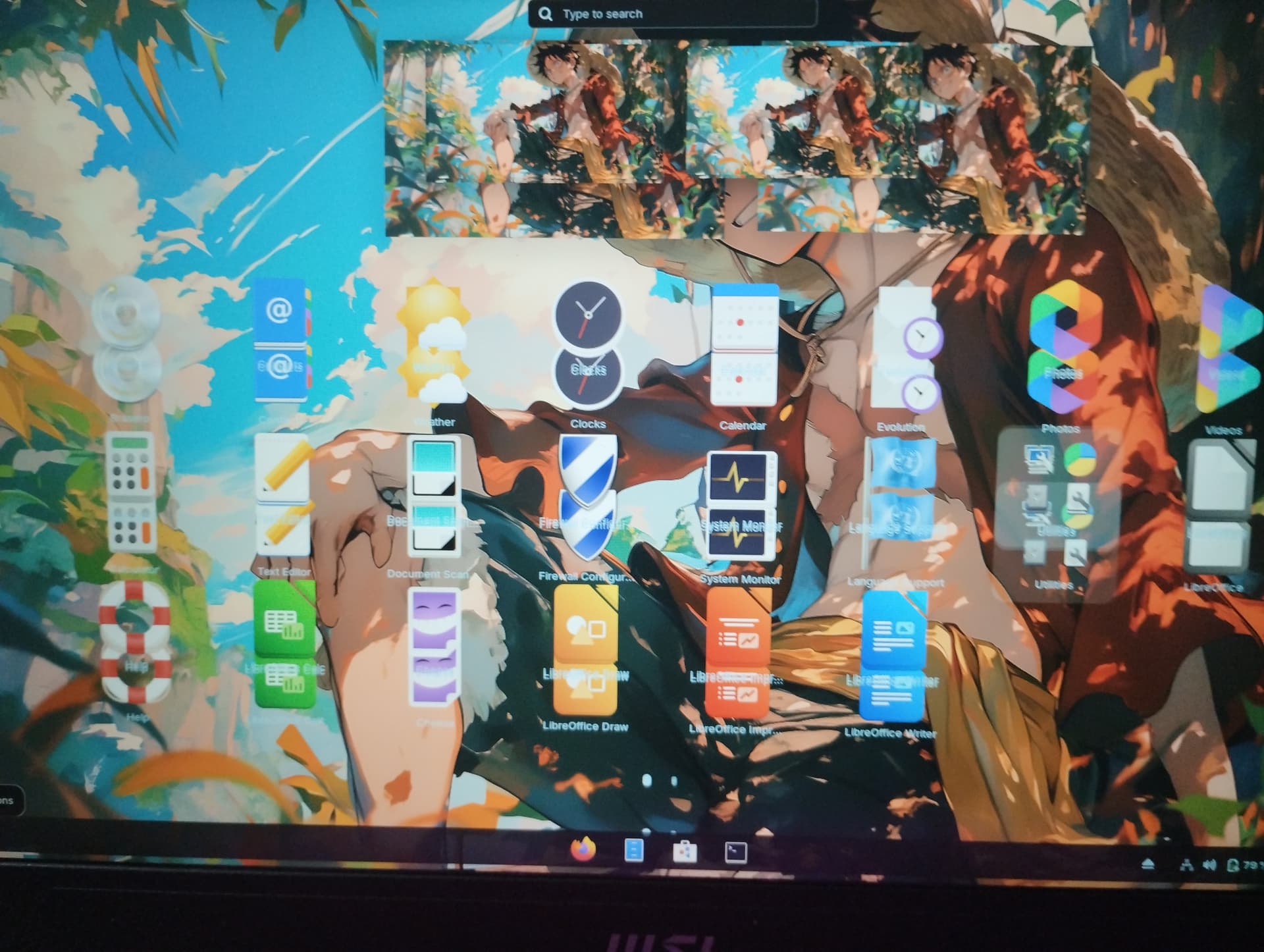

When we open the application menu the screen make some infinite mirror like glitch , 2days back it was fine but now it's seems broken I'm sure I haven't changed anything on settings.
Will share the image .
Moving the cursor make it more worse now .

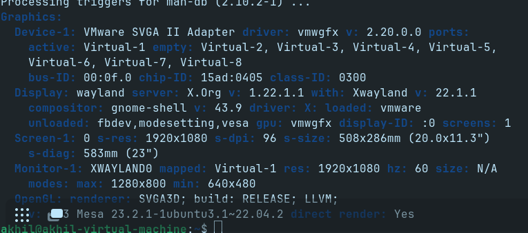

It's properly a driver issue. Please give us the output of these commands and post them here. Did you recieve any kernel updates?
sudo apt install inxi
inxi -Ga

Okay, did You tried to switch between Xorg and Wayland to control if the Problem appears? to do that go to the Login Screen and click on Your Profile so that the Password Field appears. It must appeared! Then You should see in the bottom right Corner a Gear Icon. Click on it. You should see 2 Options:
- Zorin Desktop
- Zorin desktop on Xorg
What Option ist active You can see on the Dot Marker at the Beginning. Switch from one to the other and back to test if this Issue is still active.
Switched it from zorin desktop to Xorg but the problem isn't resolved
Could You tell us Your Hardware Specs?
MSI BRAVO 15
AMD Ryzen 5 7535HS
rtx2050
Oh, you are running it vmware? I'm not sure what the problem might be then.
The problem is resolved, i used the command
dconf reset -f /
Now everything looks fine .
