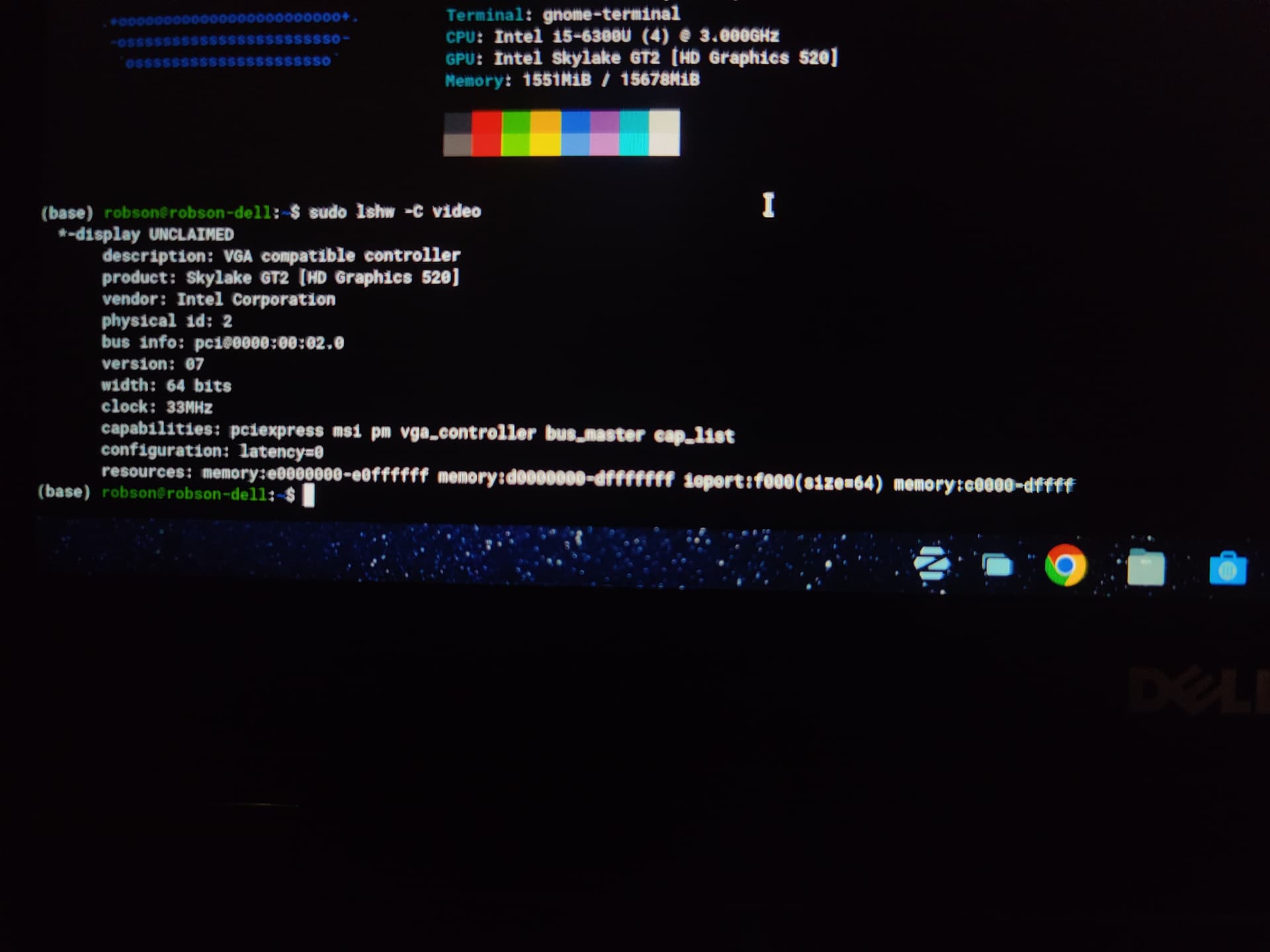

For video info, in terminal: sudo lshw -C video will show you some HW information for your video card(s).

For video info photo below. For the backstory I opened the laptop and it started to do that, so ...

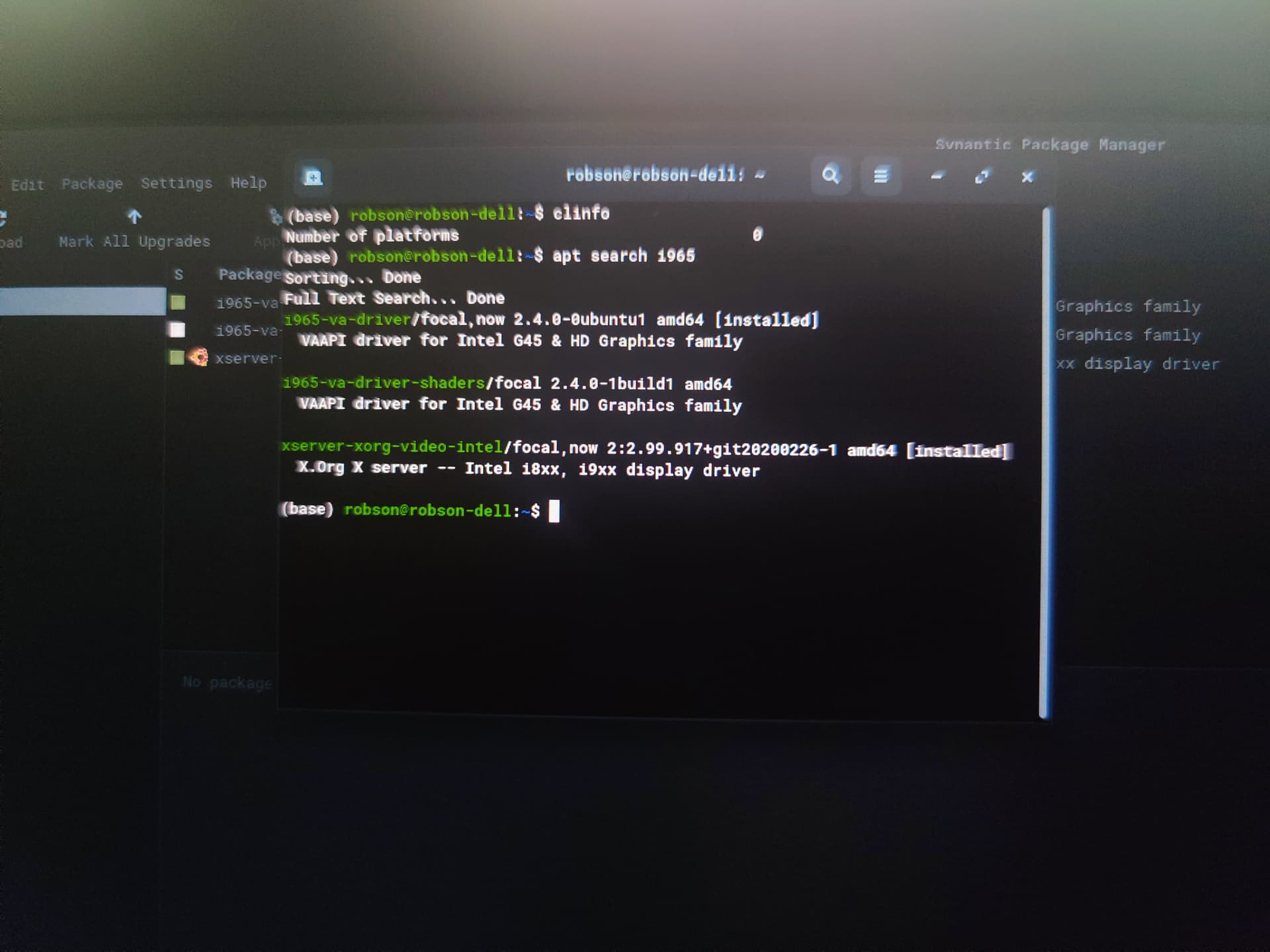

If you do apt search i965 in terminal, do you get anything with non-free drivers? I have an Intel UHD 600 series for another laptop - had to install OpenCL stuff and a non-free driver to get fully working without any tearing or issues. You can also use Synaptic Package Manager (needs installing sudo apt install synaptic) to search for these packages as well with a GUI. To verify CL is working, use clinfo to display whether it's enabled - also needs installing sudo apt install clinfo and then run with clinfo. If you get a LOT of stuff on the screen after running clinfo, then you're good to go - usually if it's missing or otherwise not working, you get a rather blank display.
But, I do see *-display UNCLAIMED on your output..

Alright, for your suggestions, I did the apt search and synaptic one and there were 3, the same, libraries. Clinfo returns nothing. Photos below. And what do you mean with non-free, as to pay for it?

Clinfo - that may not be good, not seeing any output.. do apt search intel-opencl-icd, if it's not installed - install it, then reboot. OpenCL is an Intel runtime that helps bridge the CPU with the built-in GPU - still learn-ding about it myself

After the install - did you run clinfo again to see if anything registered? Also - check sudo lshw -C video again to see if the 'unclaimed' has been 'claimed'. Should definitely get something with 'intel' where it says configuration: latency=0.

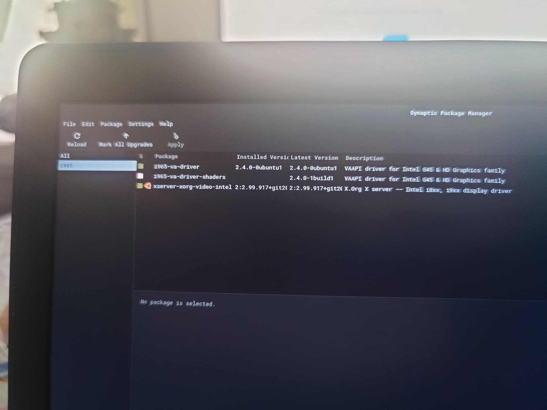

In synaptic, instead of searching for i965; search 'skylake' instead - you may see some drivers pop up that way:
I don't have any drivers installed manually; in the list there should be some non-free drivers that way, hopefully.. I have the 'intel-media-va-non-free' but not installed (screenshot), which:
Lots of support and HW acceleration, video codecs and such.

Alright, so I did a little digging myself thanks to your comments PlumpKibbles and your ideas, and basically somewhere I found in a little comment that nomodeset for GRUB_CMDLINE_LINUX_DEFAULT is an emergency argument or sth, and it should not be the default. And I remember now that I was fighting with grub, because for some reason every time I opened my laptop, I wasn't seeing normal boot, but rather cli with everything that is going on during the boot. And so, without any knowledge, I changed it to nomodeset, it didn't work, and it did not work because I never did sudo update-grub and so I left it. It somehow had to do own update I guess (I have unfortunately little knowledge of linux) and that's how yesterday it happened. Now, I updated to quiet splash and not only everything is back to normal, but also I have normal boot. So maybe for the future, as well check /etc/default/grub cause maybe it is the problem of display unclaimed. Thank you PlumpKibbles for all the help and navigating me through this, without your help I wouldn't be able to resolve it myself. Thank you so much!
