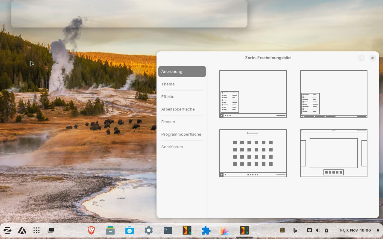

I miss the option to delay the capture in Zorin 17's (and 18's) integrated screenshot tool so that I can also capture context menus or popups. That's why I mostly use Ksnip, which offers this feature.
Unfortunately, when using Ksnip, I have the problem that the outline of the Ksnip settings window is also captured as a shadow on the screenshot as soon as I add a capture delay. So I always have to make sure that the Ksnip window is outside the area I want to capture (this cannot be avoided when capturing the entire screen).
Does anyone know how to avoid this? Is it because I use a VM?

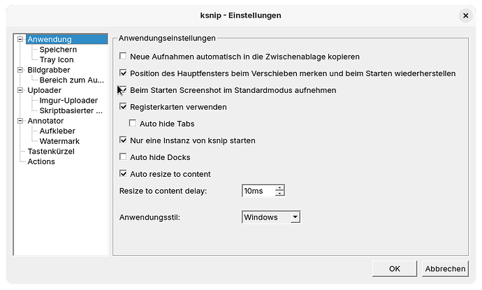

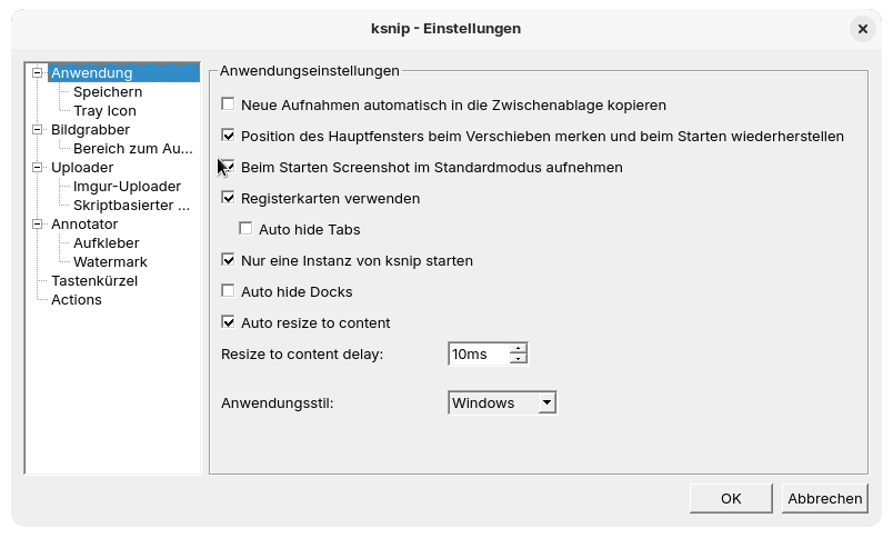

I found a solution to avoid the window shadow in ksnip:
In ksnip settings > options > application enable "Capture screenshot at startup with default mode". Then the screenshot is made automatically in the last used mode without opening the ksnip settings window and no window shadow is displayed on the screenshot .
Edit: This issue only exists in the virtual machine. On my LM XFCE bare metal installation ksnip works perfektly without producing a window shadow when a delay is set.
