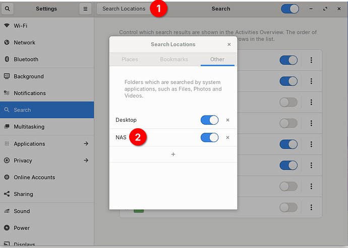

This is interesting, but GNOME Control Center doesn't exist in Zorin and I don't see any way to access the "tracker" that the AI mentions in Zorin. All I see in Zorin are for search settings are Search Locations. There is also no tracker installed with Zorin that I can find.

  1. Zorin Settings: Open Zorin Settings and navigate to Search and click on Search Locations.
  2. Click on Other: Add the symbolic link created in Step 2
