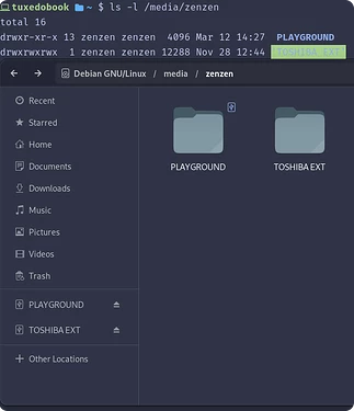

By the way, you can pick whatever names you want for these I'm just using the names of the drives as they appeared in lsblk, again for better organization. Here's a screenshot of me be not following my own advice, just to prove that the name is not that important, and as an example of how it might look:

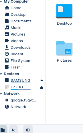

That certainly seemed to work! I can now see both the internal and external drives under Devices in Nemo.

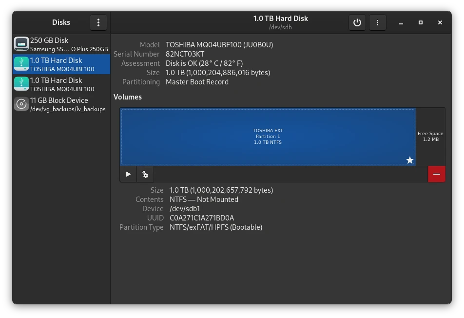

This is using my own external drive so you'll need to update the UUID, mount point and file system. To find out the UUID you can launch Disks, select the drive and the partition in question:
It's important to understand that this UUID corresponds to the file system i.e., one per partition, not the entire drive. Just something to consider when you have several partitions in the same drive. Also, if you reformat the drive or the partition at all this UUID will change and you'll have to update the /etc/fstab entry.

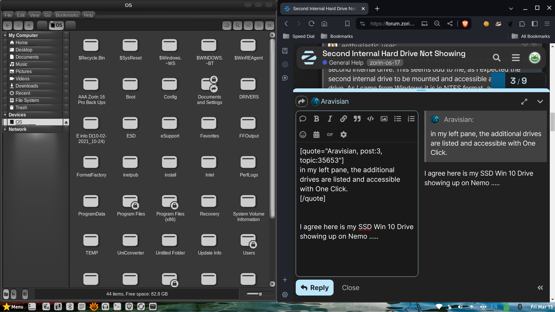

I agree here is my SSD Win 10 Drive showing up on Nemo .....
