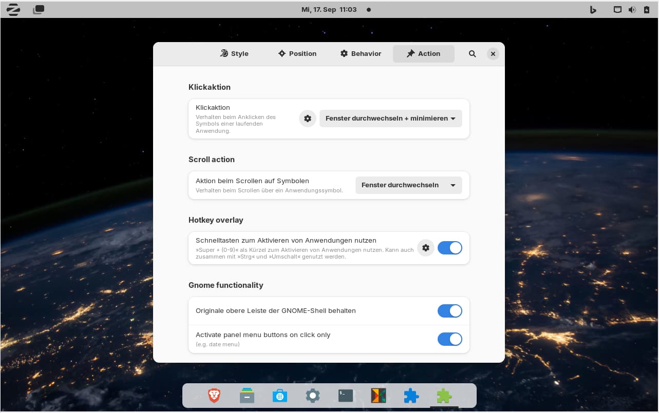

When you have a layout in Zorin Appearance that uses a taskbar, you can rightclick on the taskbar to open the taskbar settings. At tab Action scroll down and enable "Show original gnome shell topbar".
Or you can install the gome extension "Dash to panel", there you can enable the original gnome shell topbar at tab "finetune".

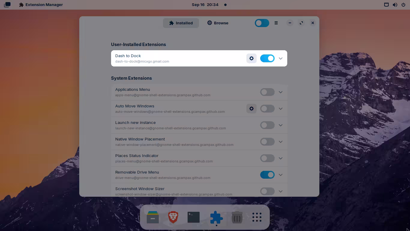

However, you can also select the regular "GNOME Shell-like" layout, and install a Gnome extension that provides another dock. It won't look the same as the Zorin OS taskbar, but it might be enough for you:
To install extensions, you can install the Extension Manager from the software store.

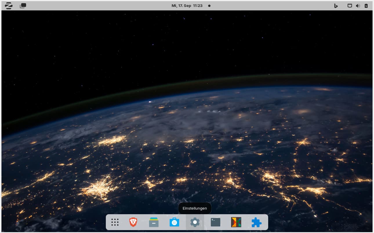

Here I used Zorin dash (dock) and the Compact Top Bar gnome extension:

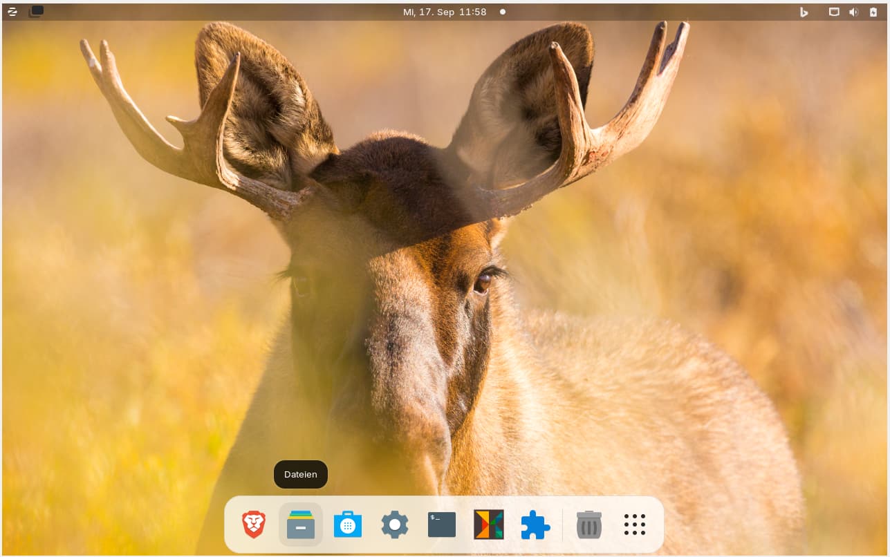

This look can be made with normal Zorin taskbar settings (it is not the dock!!!) without using an extra extension:
The length and width of the panel can be set individually.
The Zorin Dock Gnome Extension is actually installable with the Command sudo apt install gnome-shell-extension-zorin-dash
This is a Zorin modified Version of Dash To Dock.
