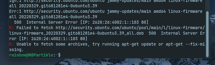

At the moment there is a problem with the ubuntu server. Try it later.
This is certainly upstream of Zorin, but I imagine the Zorin brothers know who to contact far better than I do. For ~1 hour at least, attempting to update, whether by the Software Updater or APT has failed. The software updater returns a poorly advised instruction to check Internet connection. APT returns that us.archive.ubuntu.com/ubuntu is returning HTTP 500 (internal server error, and why "check your Internet connection" is poorly advised).
I have run apt update (several times), and the i…
I am experiencing very slow down load of linux firmware update via Software Updater yesterday and again today. Maybe ubuntu server is still slow.
It appears to be still down so I’ll wait it out. Thanks again.
