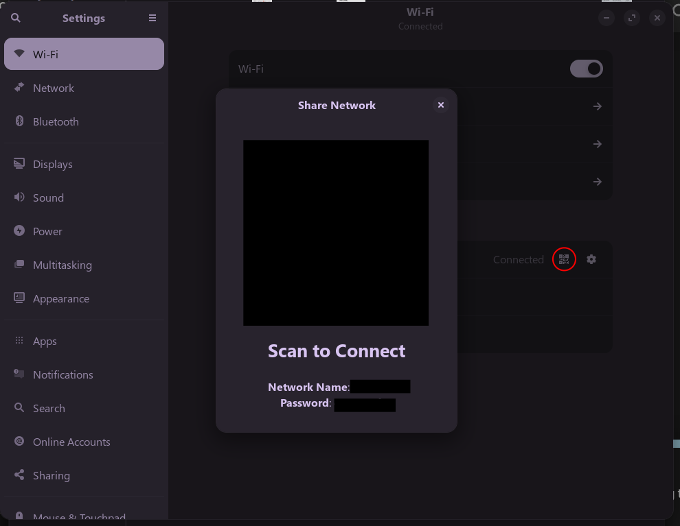

Long story short, as long as I log in, I can access this screen. The Red circle, when clicked, opens the "Share network" window shown in the middle.
The rather large square hides a QR code that lets anyone scan it to join my network. Below that, the two smaller rectangles hide (in plain text) my SSID and password.

I tested it with the Zorin 18 live session and there normal user accounts (which have no administrator rights) are not able to click on the qr code to share the network. A password prompt appears and only when you enter the root password you see the qr code and the network password and can connect to the wlan (in live session It still works because there is no root password set, but on bare-metal install it shouldn't).
