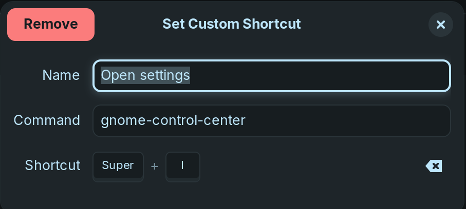

I then also wanted to create the shortcut Super + I to quickly access the system settings. However, this shortcut simply doesn't work. If I set another combination like Ctrl + Alt + I, then the settings immediately open, but it simply refuses to work for Super + I.

EDIT: As I see @zenzen's Comment now, he has a Point with the Command. What command did You add to open the Settings? It should be gnome-control-center

Are you sure the command that you've entered for the shortcut is the right one? I've just tried myself and seems to work fine (although with another launcher, I don't have Mission Center installed).

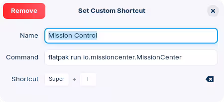

I was just installing Mission Center to see if it worked, and it did. I think the main issue might be with the way you've entered the shortcut, or maybe a typo.
With Flatpak packages, you need to provide the full ID of the app. You can find out exactly what that is by running flatpak list in the terminal. Then, run them with flatpak run <id>:

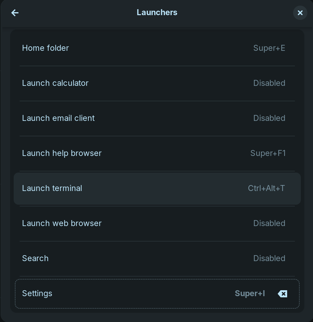

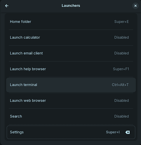

Thanks for your help. The flatpak runs fine. The problem is with the gnome settings:
This shortcut doesn't work for me.
If I enter Ctrl + Alt + I as shortcut, the gnome settings open up fine.
