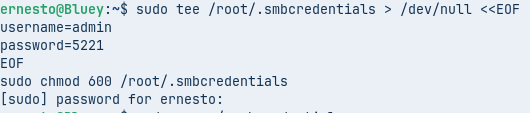

Somehow the smbcredentials file is blank even-though I did enter it as you said:
I have not yer rebooted the pc.
Any ideas?
copy the entire block and past it on terminal, not line by line
sudo tee /root/.smbcredentials > /dev/null <<EOF
username=admin
password=5221
EOF
sudo chmod 600 /root/.smbcredentials
watch you screenshot you have ">" on every lines
You said it; I didn't think and entered it line by line.
This time I pasted-in the lines as a block:
hit enter, then asked for the password and it gave no errors.

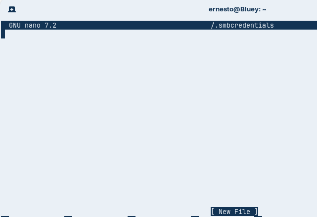

But nano still shows a blank file.
Sorry to be dense, but can one just type in the lines in the nano editor?
I wrote
sudo nano /root/.smbcredentials
the file is in the root directory
My mistake.
The credentials are now visible in Nano editor.
