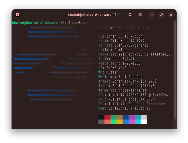

Should i downgrade the kernel or is there a better choice?
i had problem with guess what nvidia drivers again and now system can't read it or driver either
i asked ai about this and told me to do downgrade to 6.8
1-
sudo sed -i 's/eg.archive.ubuntu.com/archive.ubuntu.com/g' /etc/apt/sources.list
sudo apt update
2-
sudo apt install linux-image-6.8.0-49-generic linux-headers-6.8.0-49-generic linux-modules-6.8.0-49-generic linux-modules-extra-6.8.0-49-generic
3-
apt-cache search linux-image-6.8 | grep generic
4-
sudo update-grub
sudo reboot
soo should i or there is batter choice ?
If you have an older Nvidia card that relies on older drivers like the nvidia-drive-340, then downgrading the kernel is the correct choice.
Even the 6.8 kernel is newer than the hardware; so having the Latest Kernel on your machine brings nothing new to the table for you.
Could You offer more Details? Describe the Issue and offer Your Hardware Specs please. Also: do You use Zorin 17 or 18?
A downgrade to kernel 6.8 is recommended if you want to use the nvidia driver 470 on Zorin 18.
i use zorin core 18
For this nvidia card the latest nvidia driver is 470. You need kernel 6.8 if you want to use the proprietary nvidia drivers.
Edit: I noticed that I wrote something wrong. I had only found reports about the nvidia gtx 770 and assumed it needs the same driver as the gtx 770m, but as Ponce-De-Leon wrote, the latest driver for your graphics card is the 418 nvidia driver.
Okay, I checked the Nvidia Website for Your Graphics and they name there the Driver 418. If You want use a Nvidia Driver, You would have to downgrade the Kernel. Or You say, You use the Nouveau Driver.
