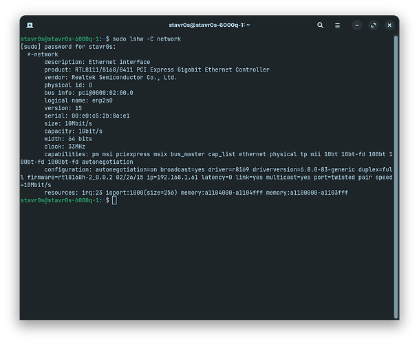

Can you please post the terminal output of
sudo lshw -C network
to show your network cards and drivers?

It is a ethernet driver that is contained in the kernel. The ethernet card is recognized.
Try to turn off the router and then reconnect, also shutdown the computer completely.
I'm not sure why there is shown 10Mbit/s as size.

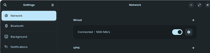

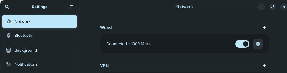

Is the internet faster now? Connected - 1000 Mb/s looks good.
I hope you can have more positive experiences with Zorin. I'm sorry that this was such a bad beginning with the new operating system and that my suggestion made it even worse.
yes faster same as it was on win-blows
