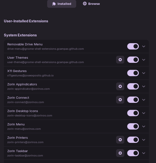

Do you have a list of the extensions installed/in use in your system currently? You could install Extension Manager and that would list all your extensions and if they're enabled or disabled. This could be a situation in which either an extension is having a bad time or a random other extension could be causing issues depending on which packages get updated or not updated.
Only 3 extensions that aren't Zorin specific:
Not exactly sure what I should be looking at/for here.
I still have issues multiple times per week. For a 32Gig ram, 16 core machine, this is abysmal performance.
Are you using a printer? And if so, how is it connected? I would recommend turning off the Zorin Printers extension if you're not, as that's what your errors are referencing (just as a test to see if that were the issue). I noticed also in the X11 Gestures extension, which version are you running? I notice that right around the version of Gnome Zorin 17 uses, there is an inactive version for some reason. Could be completely unrelated, but those are my first 2 guesses.
