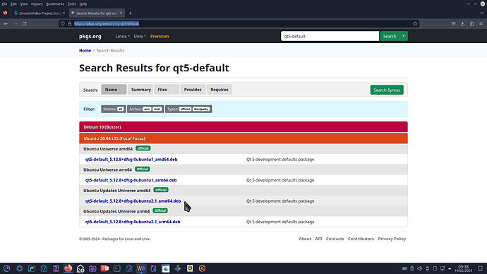

Just done a search on pkgs.org - no 'mediainfo' but there is a qt5-default developers package in .deb format but is for Ubuntu 20.04, which is what Zorin 16 was a fork of - you could try that?
it didnt work with this message :
The following packages have unmet dependencies:
qt5-default: Depends: qtbase5-dev (= 5.12.8+dfsg-0ubuntu2.1) but it is not installable or
qtbase5-gles-dev (>= 5.12.8+dfsg) but it is not installable
Sorry, maybe it wasn't good described from me. On the Screenshot You see apt list to show You that this Packages are exists in apt. Sorry again for the Missunderstanding.
