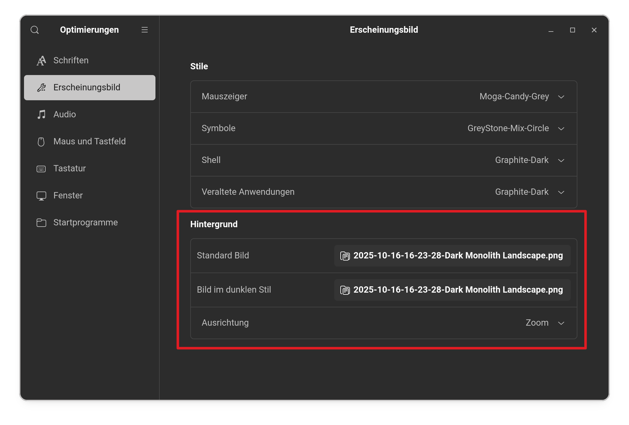

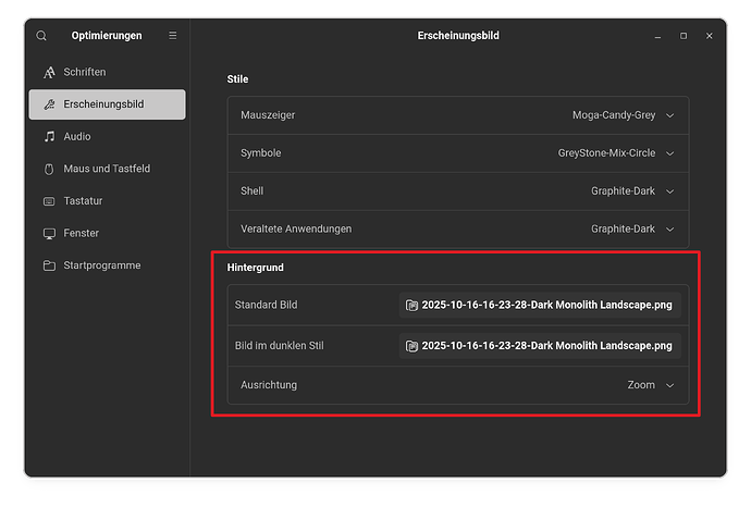

You can set up Wallpapers of Light and Dark Mode in gnome-tweaks and there in the Appearance Tab:
Yes, I see that. Seems to be new in Tweaks. That mitigates the problem. No need for another extension.
