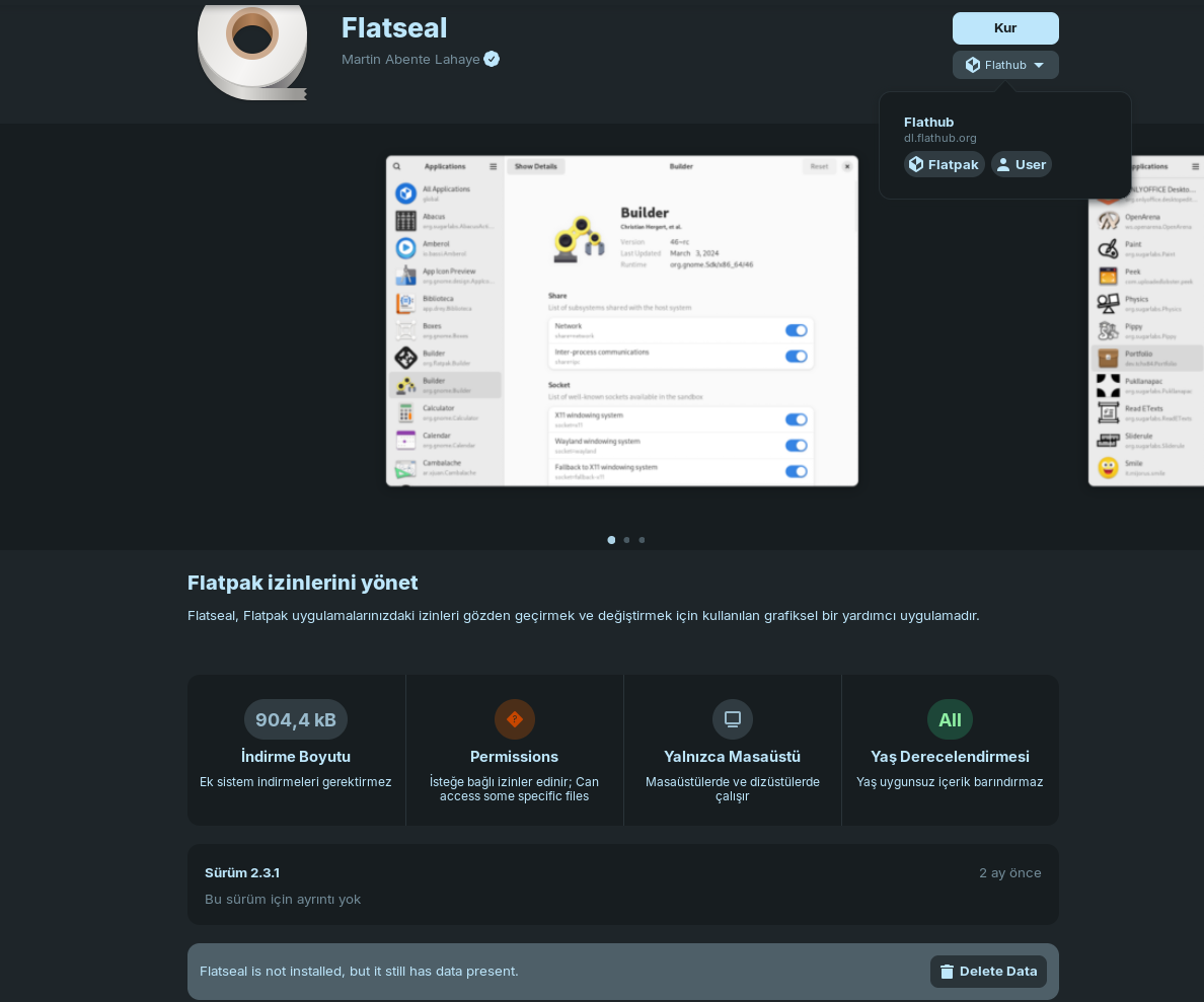

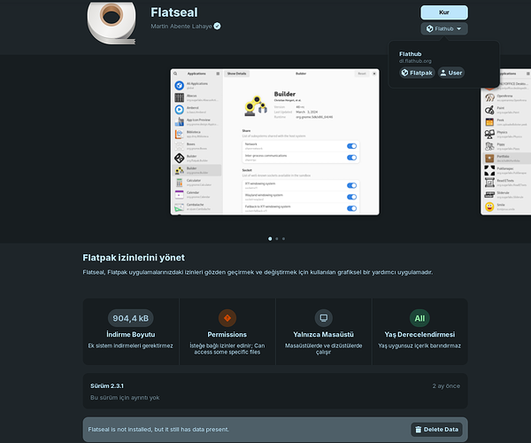

Thanks for your help. I was able to fix the issue. The commands and changing the main server didn't work, but thanks to the extra info about adding the repo as a user, I tried this code:
flatpak remote-add --user --if-not-exists flathub https://flathub.org/repo/flathub.flatpakrepo

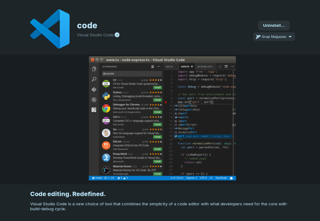

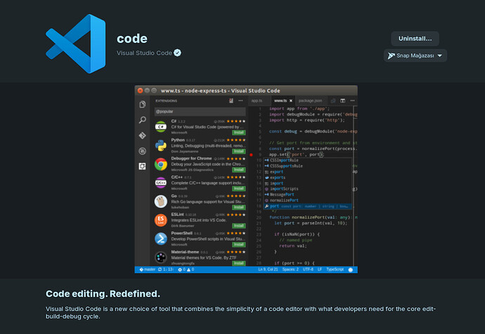

And it works now. However, it caused a new problem. In the Software Center, my previously installed Flatpaks are now visible, but they aren't detected as installed. As you can see in the image, it says "kur" (install) and below it, it says "Flatseal is not installed, but still has data present." But for a Snap app, it says "uninstall," so it's detected as installed.

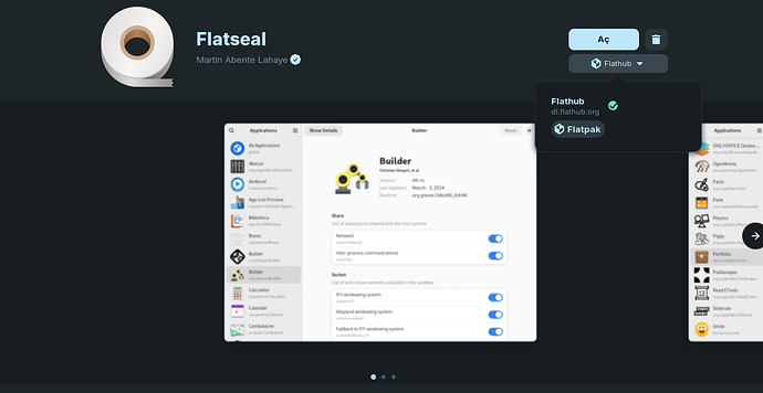

I deleted both the user and system entries based on AI advice, and then reinstalled. It also deleted all installed apps, but luckily it didn't delete the apps' configurations. So, when I reinstalled, both the problem was solved and the apps were fine.
sudo flatpak remote-delete --system flathub
sudo flatpak remote-add --if-not-exists flathub https://flathub.org/repo/flathub.flatpakrepo
flatpak update --appstream
Now, flatpak update --appstream no longer gives an error. However, it's still risky as it might delete app configurations if one isn't careful or lucky, but it works for me. Eventhough I say risky, I dont think there is another solution so maybe take backup of config files of apps before do that steps is better.
