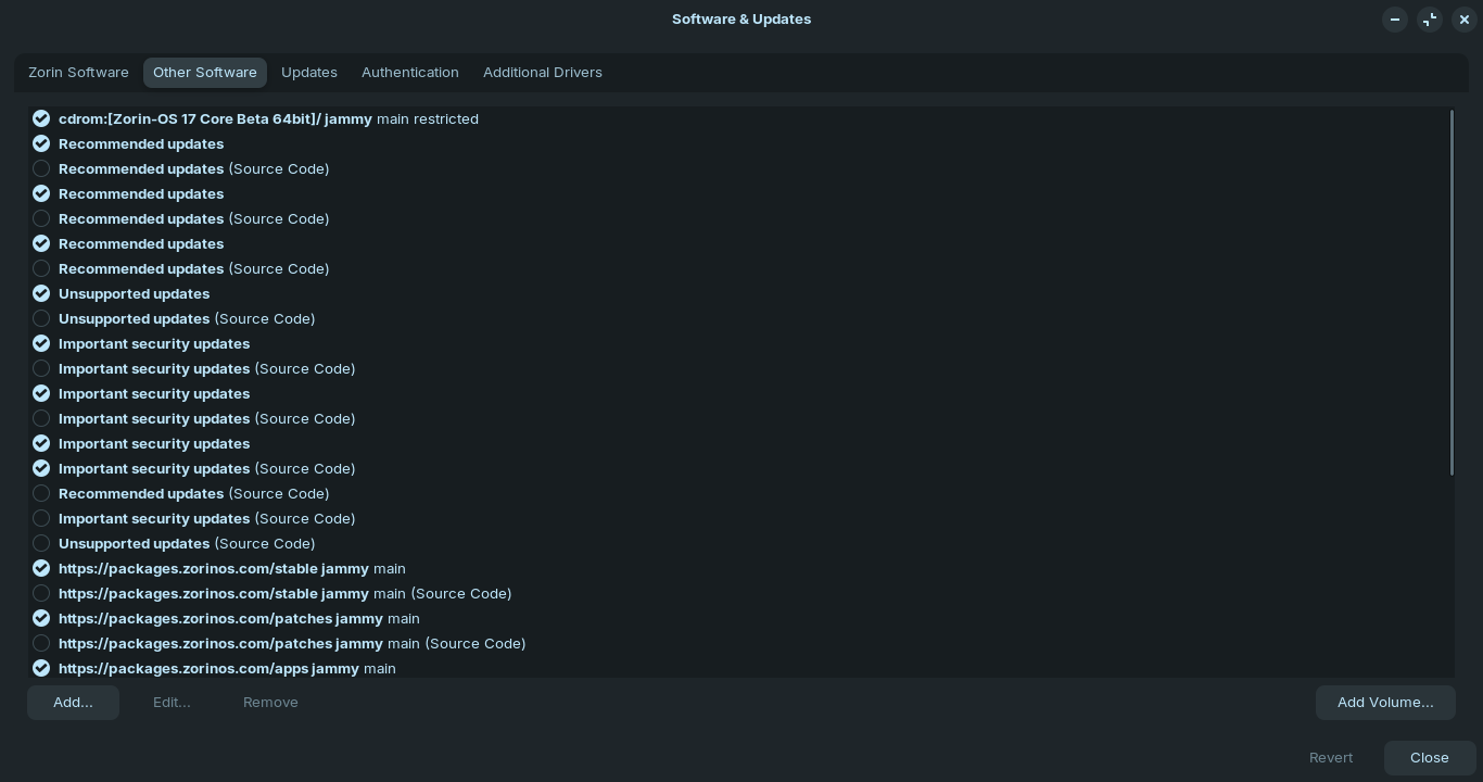

In Software & Updates
> Other Software, uncheck the option for CDROM:Zorin ...
That is only for use with you have the LiveUSB plugged in and are using it to repair or install from the installation media.
Any updates that are released after the .iso file may not match the .iso file.
thanks it worked! just one question, when will zorin os 17 education release and what are the additional software shipped with zorin os 17 pro?

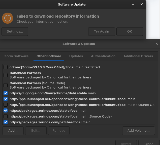

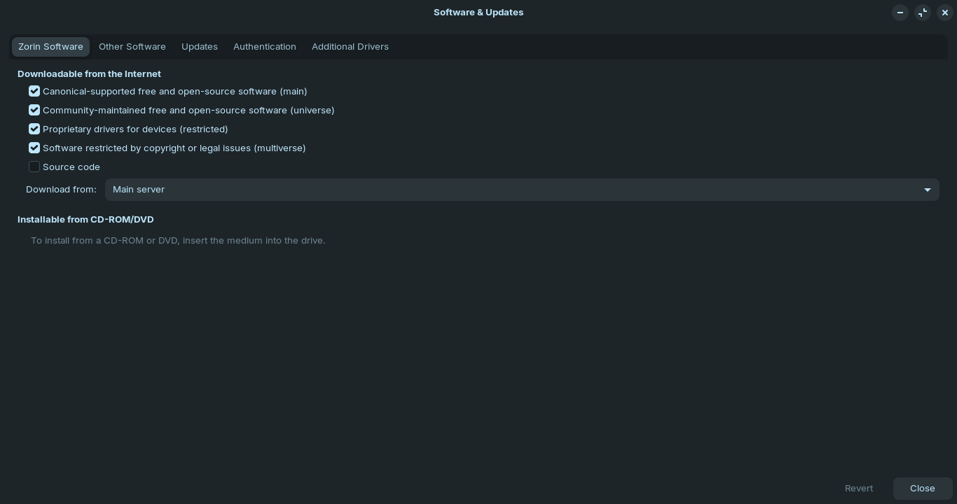

this solution not working for me
as you can see here I have this option unchecked and I got same error
