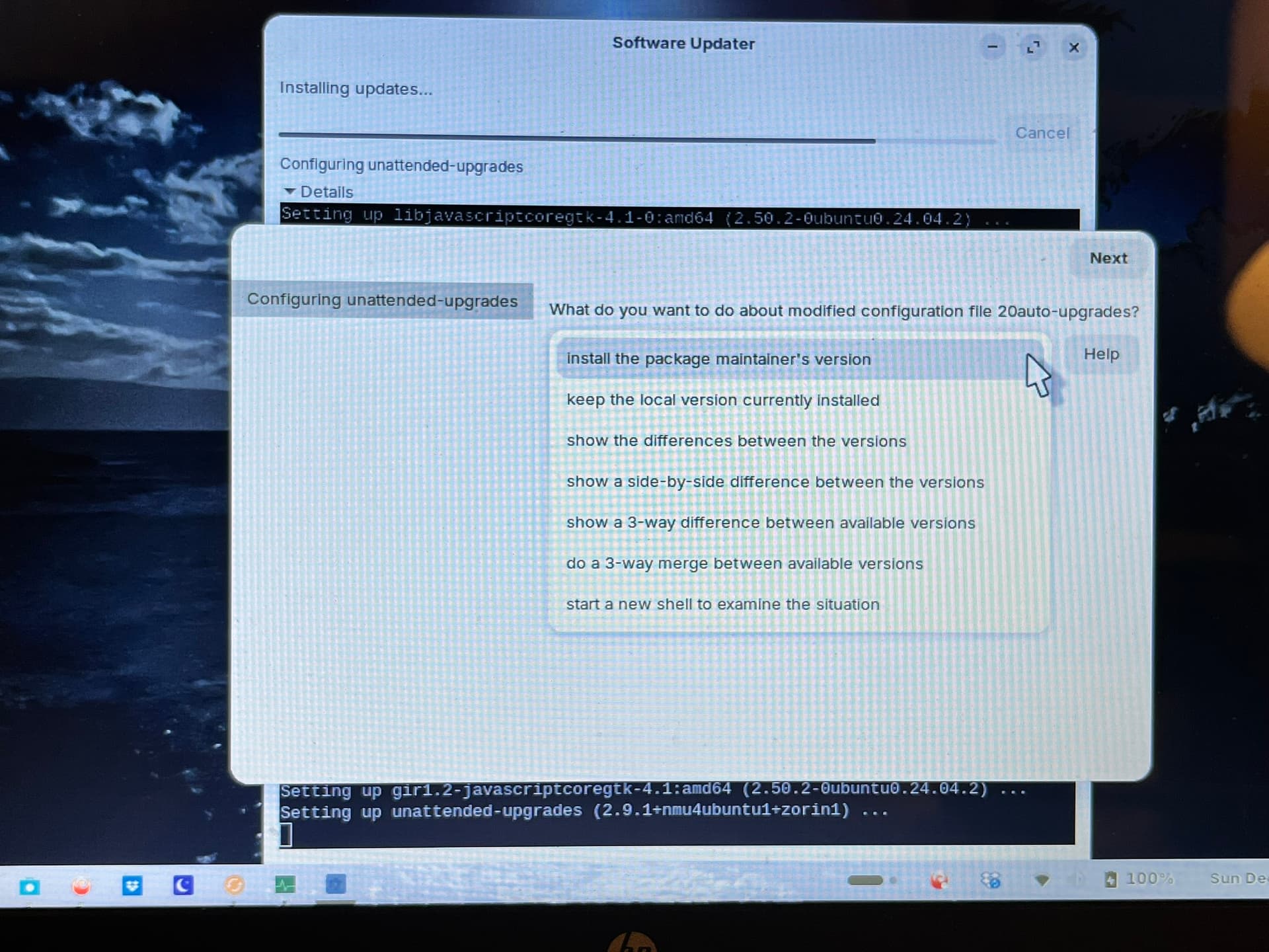

Hi. Software Updater is doing something I've not seen before and I'm not sure how to proceed so i'm looking for a little friendly advice.
While updating Software Updater stalled at "Configuring Unattended upgrades" and needs a response. Attached is a screen shot of a drop down menu with a number of options but I'm not exactly sure which one to pick.
Any suggestions or questions would be appreciated.
Thank you.
Yesterday there was an update for the package unattended-upgrades because the unattended-upgrades didn't work correctly as they were wrong configured. Probably the first selection would be the best, but wait until someone can tell you more.
Afterwards I would check the settings for automatic updates again and adapt to your wishes if they will have been reset.
Do you think it's safe to close Software Updater and terminate the update currently in progress or just leave it open for now?
Thank you.
I would install it - I think you'll only benefit from it.
Seems to have gone off with out a hitch, thank you. :folded_hands:
