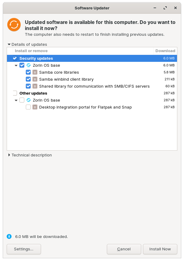

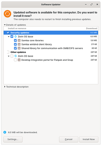

The issue just happened yesterday 20 or so minutes before I made this post and I had installed all the updates at that time. Now Zorin OS just made me install updates again then prompted to restart. I chose to restart later. I can keep postponing the restart, that for about 4 or 5 days then the same issue will happen. Usually each day even though I choose restart later, Zorin will pull more updates during that time. But when the issue happens all my desktop Icons will disappear and then the only way to get them back is to restart.
Did you keep track of which packages it's installing?
not in detail. One was Zorin OS security, there were some kernel headers, and then some font packages.
The other software items usually appear on the software tab. Occasionally I will see Firefox or Brave listed in the Software Updater pop up. The item that pops up daily that is tied to this issue is not when launching the Software store, but the Software Updater utility (icon looks like two arrows circling in an orange circle).

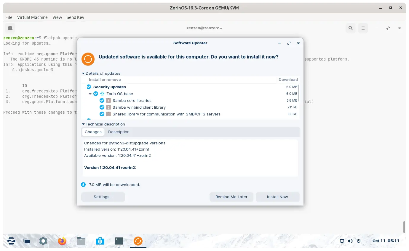

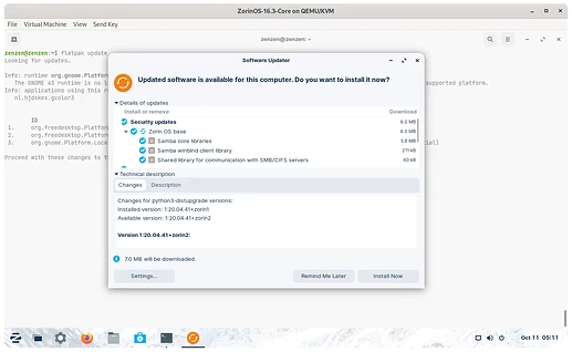

The reason being because I've recently started to see warning messages such as this one, advising that the Gnome 43 runtime has reached end of life (and therefore older runtimes must be also unsupported):
Info: runtime org.gnome.Platform branch 43 is end-of-life, with reason:
The GNOME 43 runtime is no longer supported as of September 20, 2023. Please ask your application developer to migrate to a supported platform.
Info: applications using this runtime:
nl.hjdskes.gcolor3
Now, even with this warning, my system doesn't seem to complain about it in the regular software updates. And this is on a virtual machine which I only update around once a week, so delayed updates lagging behind also seems unlikely.
But then again I have no snaps on this system so it's possible that the same logic is true for snaps, which may then be the ones causing trouble. I suppose it could also be that some previous update has gone wrong somewhere along the way and left the system damaged somehow.

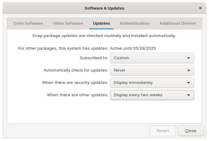

This isn't a new issue. It has been happening since I installed first installed ZorinOS back in 2021, even before enabling snaps.
I have had the OS set to NOT check for any updates at all for over a year and it still does it daily. I can't turn it off. Its like it ignores me and if I try to ignore the updates the issue happens.
If you want to try to recreate the issue, On that software updater page. Keep clicking remind me later. Leave your computer on 24x7, but when you go to sleep lock the computer with Window button + L. The next day when you unlock the computer, it will ask again about the updates. As you keep doing so the list of updates will get longer and longer because the system keeps checking for updates multiple times a day. Keep choosing remind me later and leave the computer on. I rarely ever shut this computer off and it urks me this makes me do so. Its one of the main reasons why I don't use Windows 10 or 11 as my daily driver.
At first I thought it may be a memory issue given that I tend to keep 20+ browser tabs open all day, but with 32gb of ram and a 8c/16t system that should not be an issue.
This is as close as I can get to turning off the updates.. based on these settings it should not be checking daily, but it does as I can't tell it NOT to look for security updates.

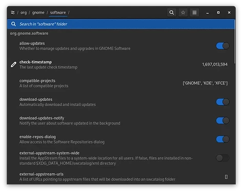

I found this thread on the Ubuntu forums where a user reported a similar issue, and solved it by disabling software updates using dconf. I'm not sure if it's installed by default but you can easily install it with:
sudo apt install dconf-editor
This is the GUI editor as it's easier to navigate. Then as per the thread, go to org.gnome.software and disable "download-updates" from there, and let's see if this makes any difference.
Thanks a bunch, @zenzen . It worked for me.
Updates are disabled and there are no more notifications.
