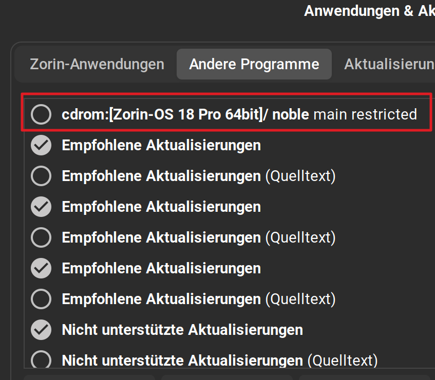

Open Software & Updates and take a Look at the ''Other Software'' Tab. Unmark the cdrom Option:
It should be disabled by default, but if not, disable it.
Also: After this could You post the Output of sudo apt update && sudo apt upgrade please? I would like to see if the Sources are all okay.
Disabled the cd.
