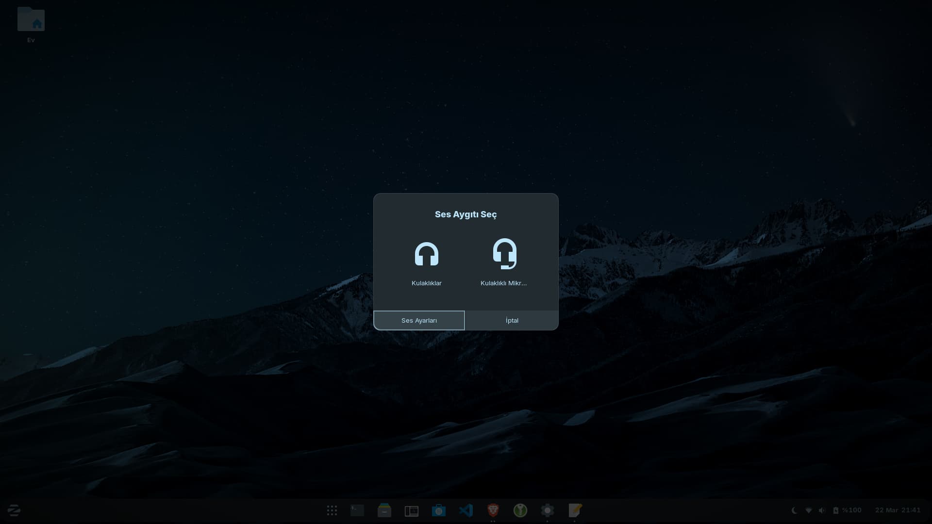

When your computer boots up, plug in your headset. A selection screen like the one in the picture will appear if your driver fixed the problem
(*Depending on the driver you chose, there might also be an extra microphone-only icon.)
I had been struggling to make my headset work properly and consistently with linux distros on and off for a few years now, but this fix was among the most straightforward ones. On my end here, the "Select Audio Device" pop-up already showed up at first but the Sound settings screen did not show any input device beyond the built-in microphone. Tried anyway, copied the config line, replaced the device name with mine, poweroff and back on, open settings again and now there it is the microphone in the dropdown list. Thanks for taking the time to make a guide for this, will be handy in introducing more linux newbie friends to Zorin.
