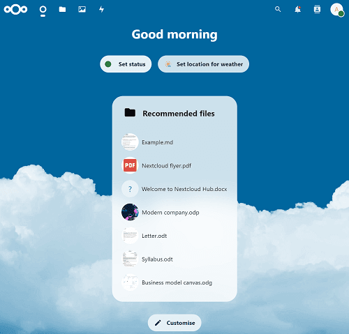

[nextcloud ubuntu 24.04 dashboard view]
(unable to have standard user use NextCloud web app in Ubuntu 24.04 no local server - Brave Search)

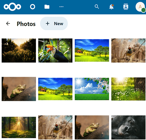

nextcloud ubuntu 24.04 photos view
