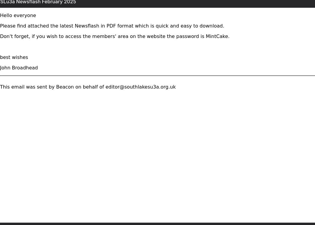

Where did the pdf come from?
It's a pdf I viewed in Evince, then saved to the desktop
I meant where did the pdf come from, disregarding Evince. What is the subject matter?

It's a pdf from an email for the U3A (University of the Third Age)
And now I CAN delete it! Bizarre!
