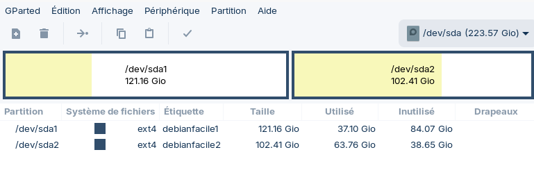

Hi and welcome. Can you boot into Zorin with the USB drive, select Try Zorin, then launch GParted and take a screenshot to show us your current partitions.

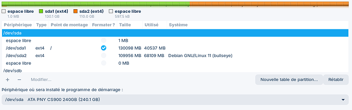

Hi thanks a lot for your help and reply.
Here the scrrenshot with the installer :
And here with gparted :
Can you please take a screenshot of the partitions of /dev/sdb, too?
OK, so I'm a bit puzzled as none of the partitions are marked as bootable, and the Debian Bullseye partition does not have any label and no flag, so puzzled how you can boot at all. Clearly there is no /boot/efi partition which is what Zorin will be looking for. Which part of the drive are you attempting to replace as I think if you delete either I can't see how you will boot the other OS. Did the machine originally have Windows on it? Does the BIOS have any reference to EFI, Fast Boot or Secure Boot?

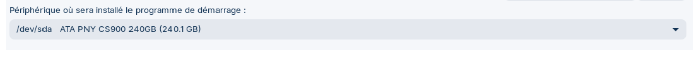

Hmm ... from this Point on, theoretically you would have to delete the Partition that you don't want to keep. then start the Zorin Installer, choose the ''Something else'' Option and for the free Space choose the ext4 File Format and / for the Mounting Point.
And under the Partition Table, you would choose the Place where Your Bootloader is. But You don't have a Boot Partition. When You click on this:
what Options are shown to You?
Thanks for your help. I'm trying to use Ventoy now. When using Ventoy, if choose normal mode, the error message is the same. If choose grub2, let's see, I'm actually trying this.
When I click for the place for the bootloader, I can choose sda or sda1 or sda2.

Well let's try, I'm trying to install it choosing sda1 for the place for the bootloader.
Well it works :slight_smile: As the bootloader used was the sda2 one, and I had indicated to use sda1 to set it, when rebooting nothing had changed. I then went into debian on sda2 and did a sudo update-grub2 and that made it possible to have zorin proposed at boot. I'm very happy that it works and that I can finally test this famous Zorin OS education :slight_smile: Many thanks to all of you for your help.
