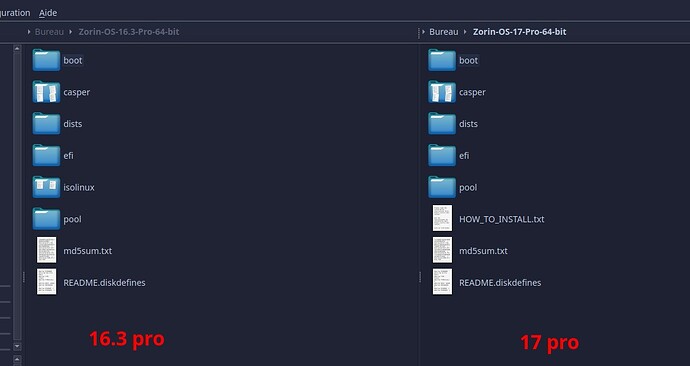

Yesterday I bought the 17 pro version and it is impossible to boot from usb, I created the usb key with balenaetcher
To be sure that it doesn't come from my computer or my USB key, I put the 16.3 pro version back on the USB key and it works, the computer starts on the USB key and I can install 16.3
I think the isolinux folder is missing in the iso file for version 17 pro and that must be why the usb key does not boot

It will not be long before the Zorin Upgrader tool is officially released for use on Zorin OS 17, so one option would be to hang out on Zorin 16 and then use the Upgrader to bump it up to Zorin OS 17.
Yes, I agree... With that many attempts, it seems a lot less likely that it is a download issue.
But we also know that files are not missing from the uploaded Zorin OS .iso file.
Some users have noted some odd quirks, though. For example, switching from burning with Balena Etcher to using uNetbootin, Rufus (Windows OS) or Ventoy worked for several people when they had issues with booting the USB.

Same issue here, trying to create USB with balenaEtcher on Windows, kept failing. Even tried another USB drive and it failed. Put Zorin 16 back on one of the drives with no problems. So changed to Rufus instead, and now I am installing Zorin 17. Thanks for the suggestion!
