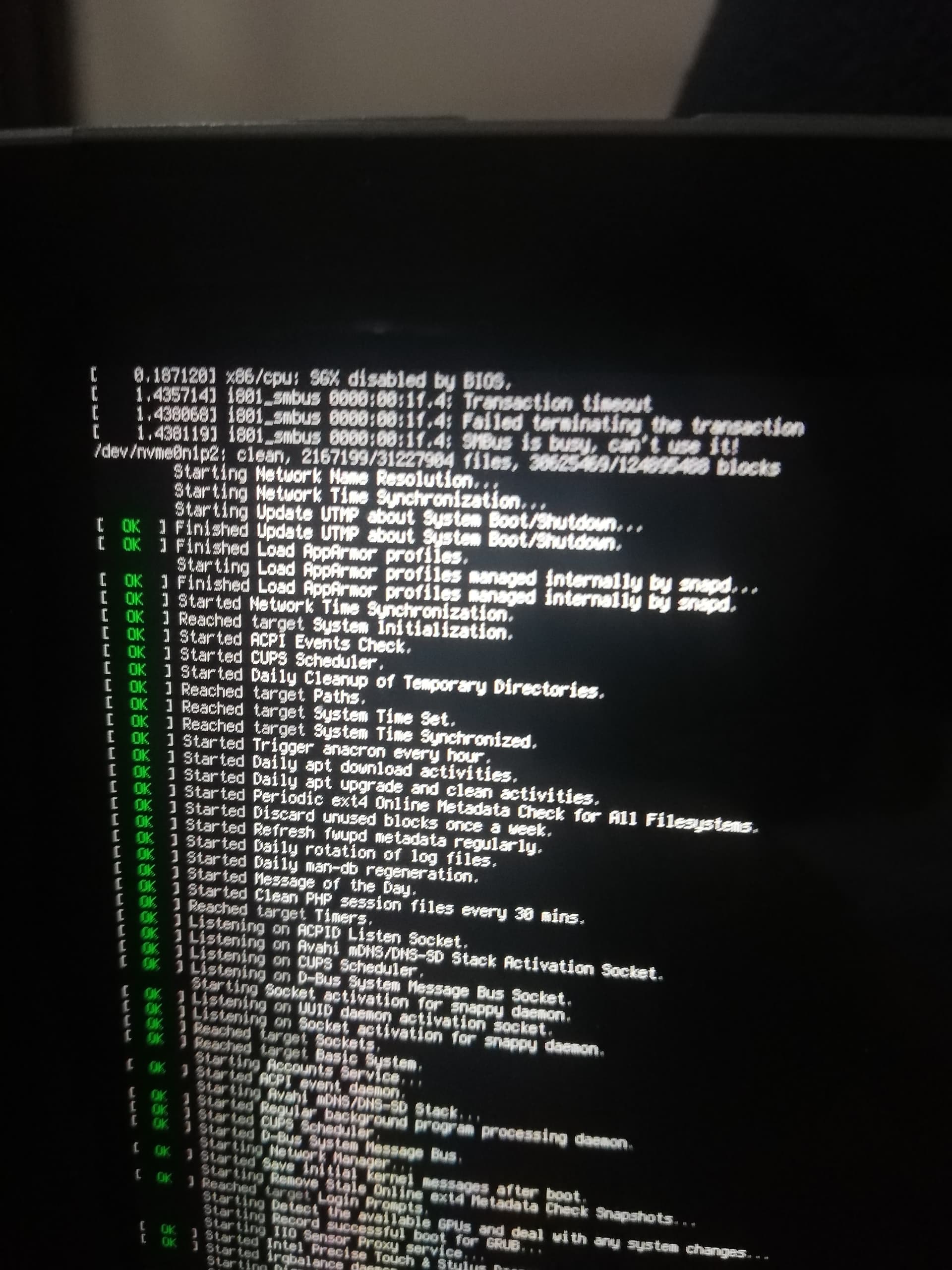

In middle i found that some commands were not working so i started reverting my steps, on one of apt remove commands i think i was removing libspa20 Bluetooth my screen became dark and it rebooted to cli mode no desktop, i read some more articles and after installing gdm3 i lost access to cli and am stuck with following screen image attached, help

P.s. current error on the screen is Smbus is busy cant use it.
That may have always been there. That deals with the kernel thermal monitoring.

Can you reboot and when you start seeing the Motherboard Splash Screen, start tapping the tab key like crazy.
This should pull up advanced Options for zorin
Try booting from an earlier kernel.
If that fails, choose Recovery and see if you can access enable networking then back to the recovery menu, drop to prompt.
I almost broke my finger clicking tab but nothing happens
Try esc key... You may need a finger splint.
Previous kernel didn't work i am in recovery, which one do i chose ?
Make sure you have an internet connection when running the recovery menu.
First enable networking from the menu then select 'Root' option - Drop to root shell.
At the command prompt enter:
sudo dpkg --configure -a
after completion run this command in case any packages are missing:
sudo apt-get update --fix-missing
After completion, shut the machine down - do not select resume or you will be in the same situation prior to attempting to sort this out.
After the machine has shut down, boot it up to see if the issues have gone away.
Did everything above Still stuck on loading screen, only thing is not sure what you meant by selecting resume i just switched of my notebook and waited after clicking power button
