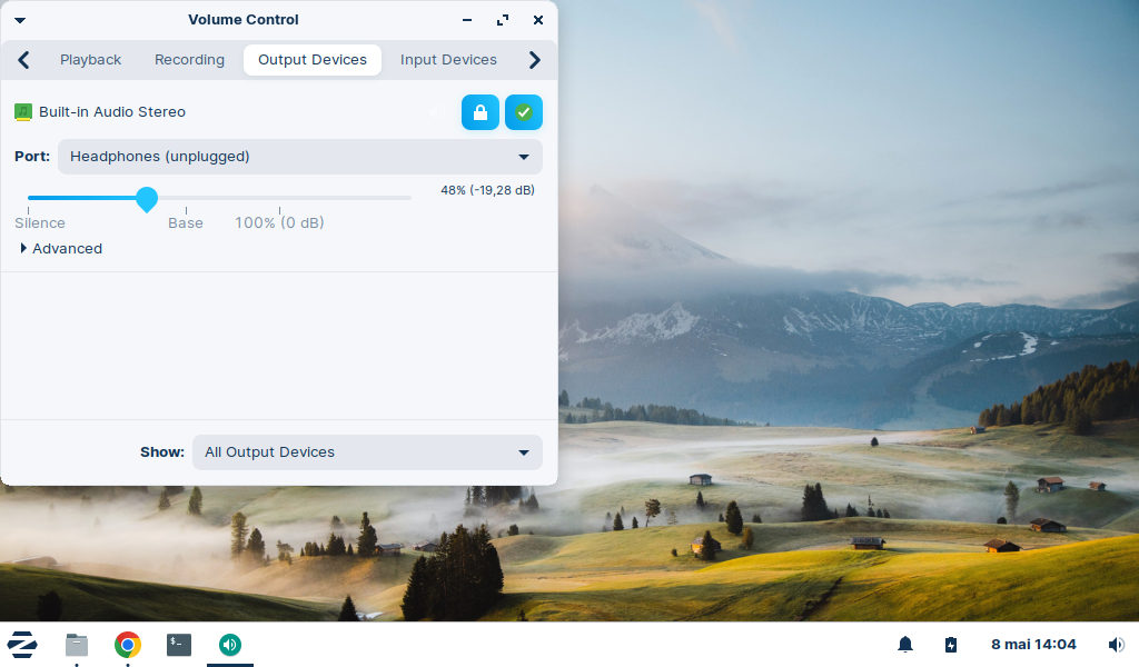

Can you check in the audio mixer, under output devices, and show the available devices from the dropdown? Not visible on my laptop, but my desktop at home likes to default to the hdmi audio (disabled on my monitor) - Just checking here to see that all the audio devices show up. and That it detects your headphones plugged in.
Screenshot_2022-05-08_02-42-39
Hellow after inserting headphones they are not detected , but the green sound bar moves when music plays .
