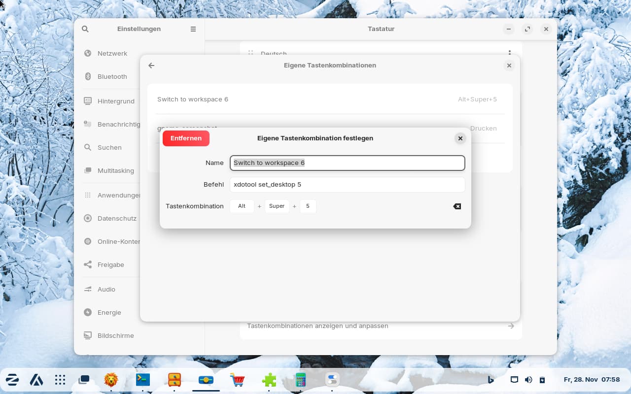

Does anyone know what command to enter if you want to create a custom keyboard shortcut for switching to workspace 6, for example, in the normal keyboard settings? I haven't yet figured out how to modify the gsettings command to enter the key sequence using the keys on the keyboard. That would be much easier than figuring out the command sequence for the bracket.
Edit: With xdotool it works to set custom shortcuts for switching workspaces, but xdotool is for Xorg only, not for Wayland. You can install xdotool with
sudo apt install xdotool
The workspaces begin with number 0 in xdotool, so if you want to go to workspace 6, you must enter 'xdotool set_desktop 5', for workspace 5 'xdotool set_desktop 4' ...

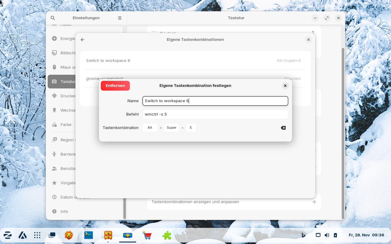

Or alternatively you can use wmctrl. Install it before with
sudo apt install wmctrl
The workspaces also begin with number 0. I'm not sure if it works with Wayland.
