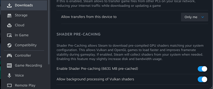

As the Reddit thread notes, despite the name of the setting, it does work for foreground processing as well as background. One thing the thread doesn't warn about is that if you keep Steam open and a game updates, Steam may start working on these in the background, if you have background shader processing turned on. If you're doing CPU intensive work, you may want to close Steam or turn off background shader processing to keep Steam from monopolizing your CPU. The option is under Downloads in Steam's settings:

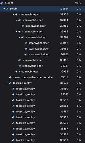

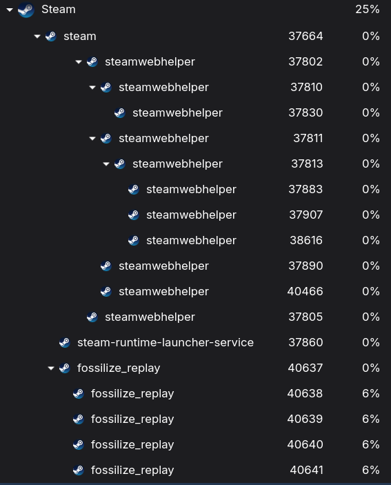

Testing was performed by downloading Persona 5 Royal from Steam, with background caching options set exactly as they are in my screenshot in the original post. Processes were monitored with Mission Control because it's convenient and because it provides a nice per-logical processor CPU activity display. After testing with the file in place, Persona 5 Royal was uninstalled, Steam was shut down completely, the file was removed from ~/.steam/steam, Steam was restarted, and Persona 5 Royal was installed again. The difference was dramatic:
With steam_dev.cfg
As you can see, CPU utilization was up relatively high, split in small amounts across 10 processes, which is the number I chose in my steam_dev.cfg
Without steam_dev.cfg
Without the file, there are four processes, and activity on eight "virtual processors" (remember above about two per physical core). This is different from the one core claimed in the original post from which I took my information to be sure--I've got four cores being used without the file, not one.
