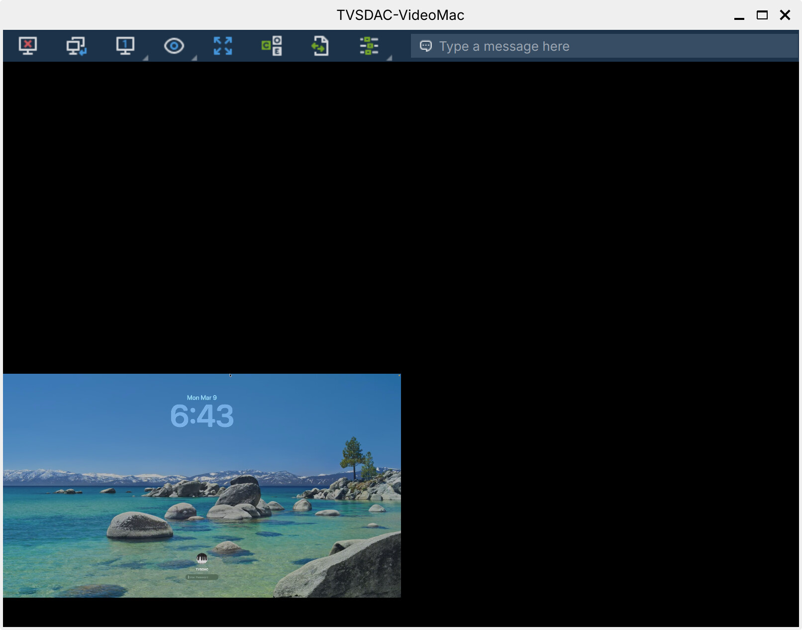

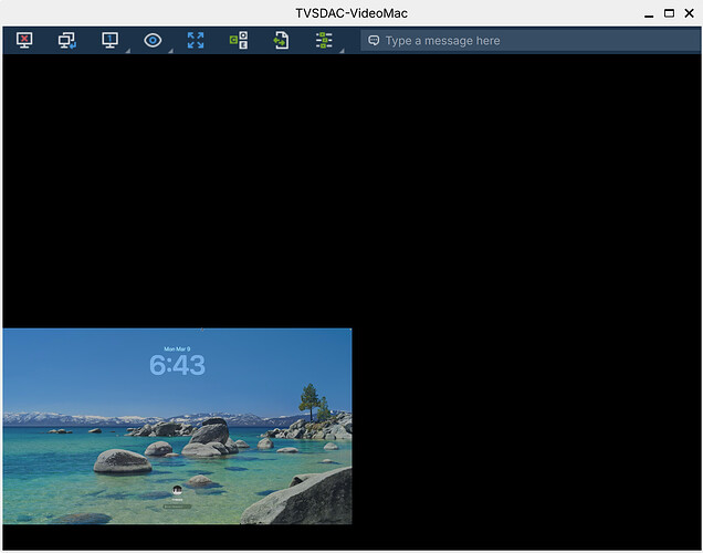

Hello everyone, I'm a recent convert to Zorin OS and am really enjoying it. I am experiencing an issue though with the Splashtop for Business viewer app. It installs fine and runs but once I connect to a computer, the remote computer is shown only in a small square on the bottom left of the Splashtop window. The mouse cursor acts as though the video was full screen. If I try and go full screen I just get a black screen and have to force close the Splashtop window. Any suggested would be appreciated.

I did at least attempt to install the Surface Kernel which then caused Zorin not to boot until I disabled Secure Boot. Running uname -r, I get: 6.18.7-surface-1
I tried changing the Resolution settings under Splashtop's Connection Options for a particular computer I was testing connecting to, but that did not help.
I also tried changing my Surface's resolution but that did not affect the issue either.
I have the same issue regardless if I am connecting to a Mac or a Windows PC.

Splashtop for Business does not run well on Wayland. At the login screen of Zorin, when you select your username a cog appears lower right of screen. Click on it and select Zorin on Xorg.

Thank you for the reply. I was wondering if that might be the issue. I tested choosing Zorin on Xorg on login and that fixed the issue allowing Splashtop to display correctly.
