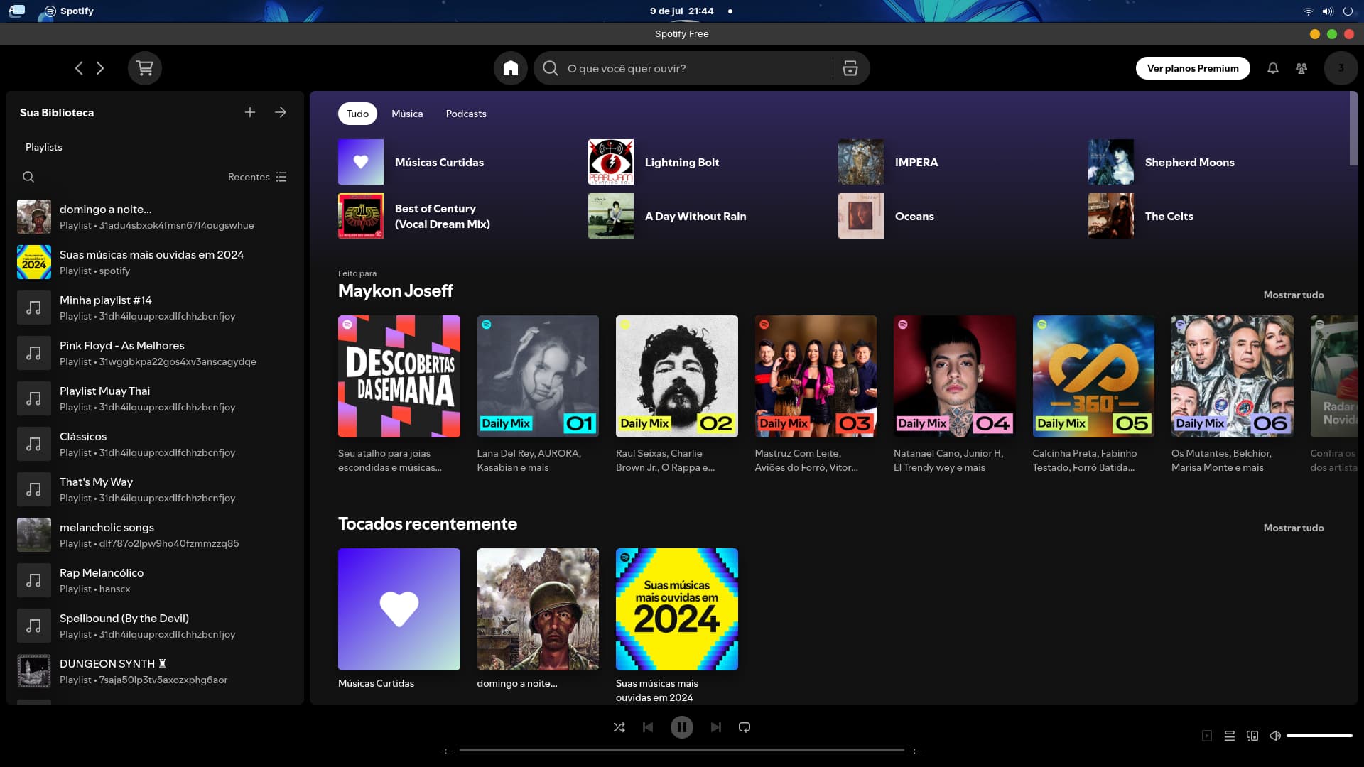

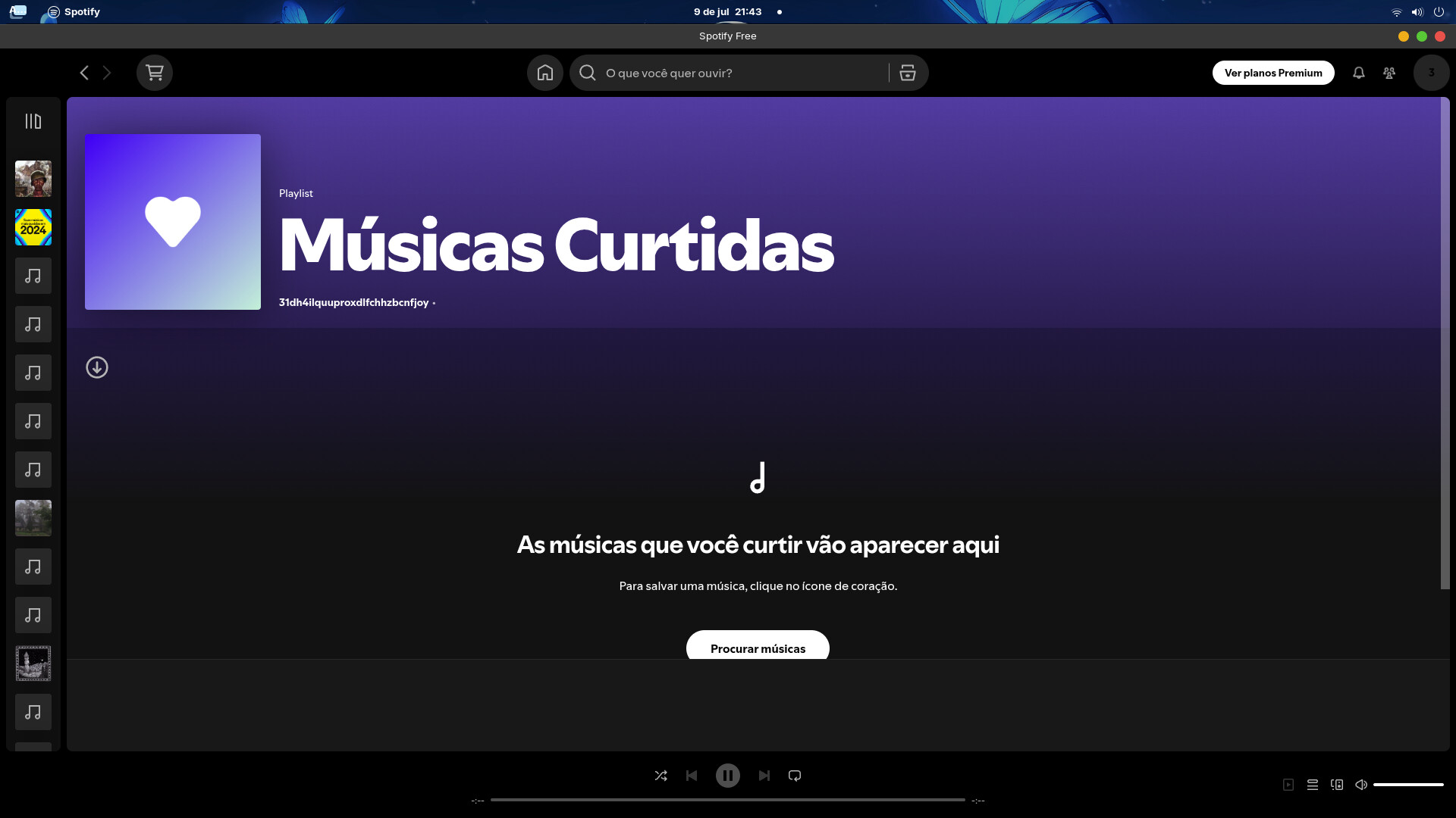

I installed spicitify normally, visually everything was fine, the themes and such. but all the songs in my playlists have disappeared and I can't play any of them. not even searching. help mee
that strange name below the playlists isn't even my username. What the hell did I do wrong?
