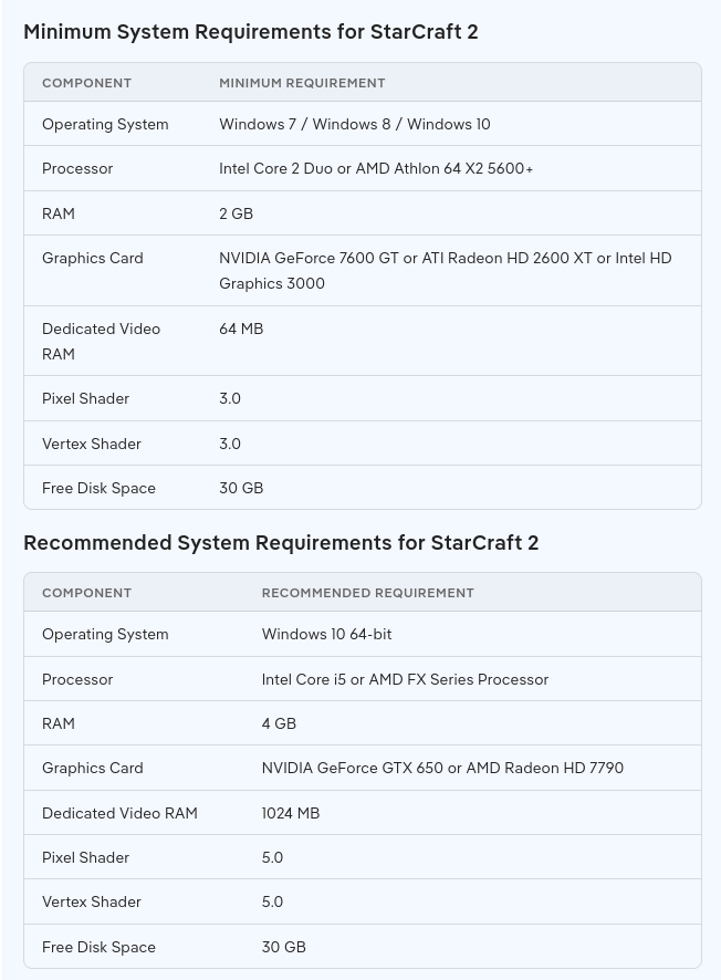

Does this happen several times or was it the first Time this happened? What are Your Hardware Specs and what Specs wants the Game?

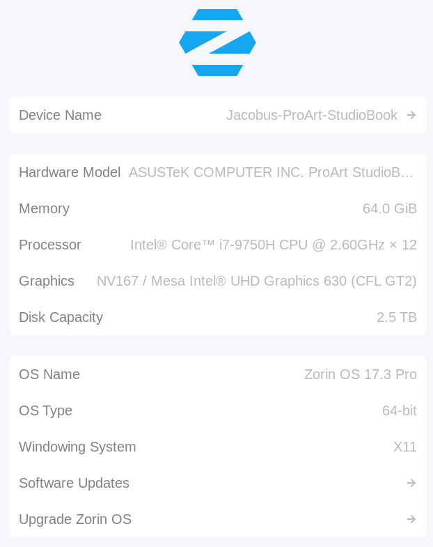

The OP is running an Asus ProArt StudioBook system...
(1) 9th gen Intel Core I7-9750H 2.2GHZ 6-Core CPU.
(2) 64GB of RAM
(3) Quadro T2000 GPU with 4GB VRAM
(4) Disk Capacity 2.5TB
(5) Zorin OS 17.3 PRO
(6) Running in X11
It appears to me, that the OP's system exceeds the system requirements, by a whole lot.
The Quadro GPU cards are Nvidia's workstation GPU offering. While typically not meant for gaming, should be able to handle powering up old games like Star Craft 2, which have Windows 7 era of system requirements.
I'd suspect there is a driver for his Quadro in Additional Drivers.
I think the main reason for the OP's issue, is that they are running in "MESA" drivers, only meant for Intel integrated SOC GPU's.

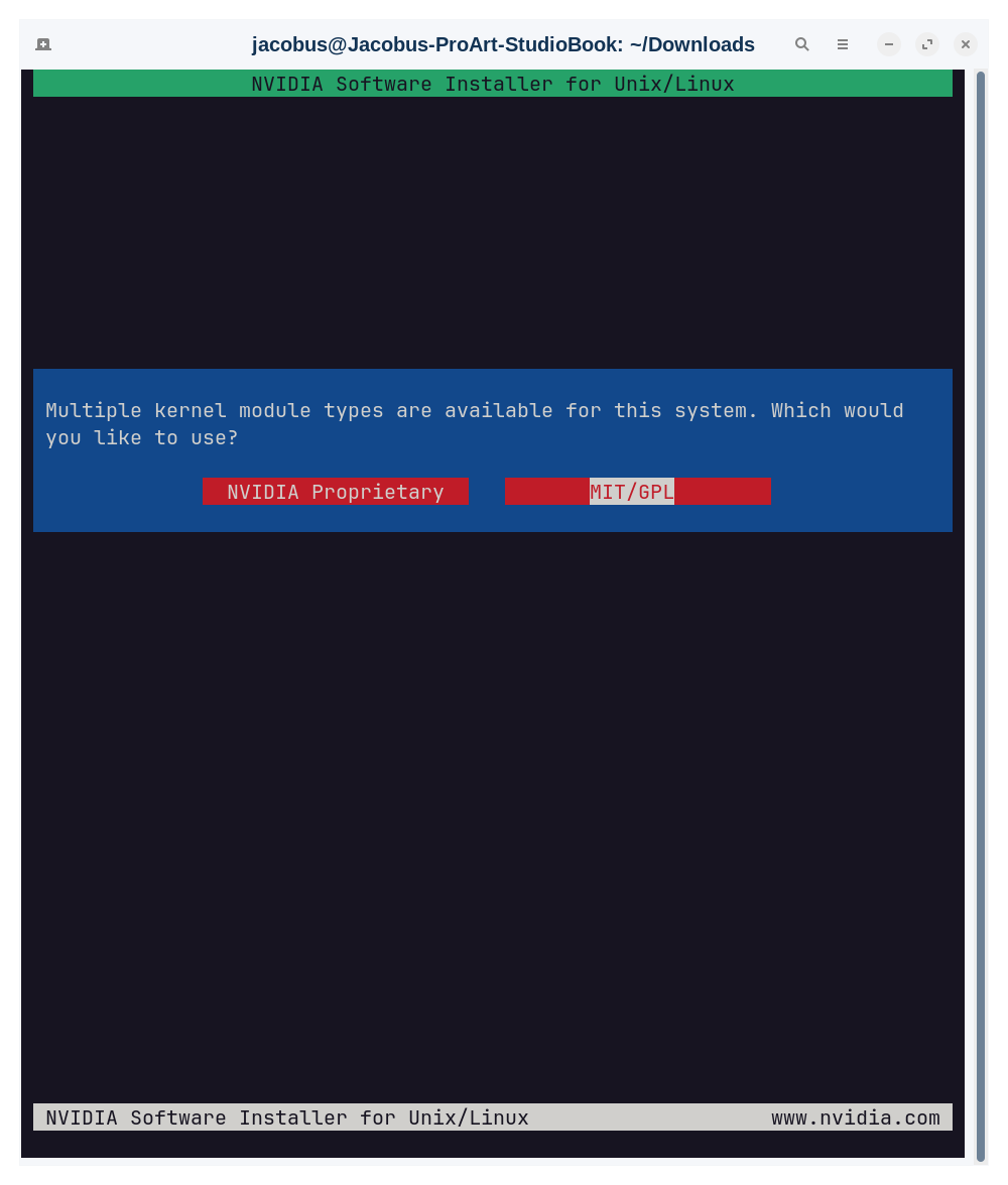

I decided to re-install the Nvidia drivers, latest on the Nvidia website, and got this message. Which do you recommend?
