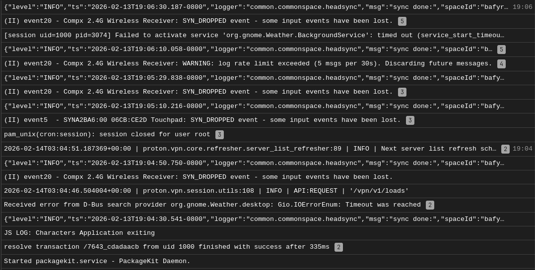

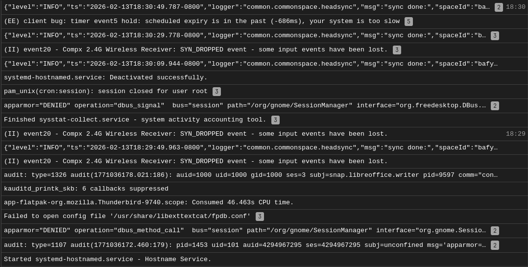

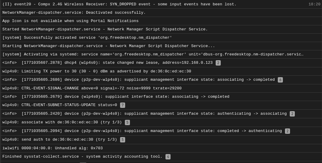

I don't think I see this issue in logs, I did screenshots after I experienced freezes. From what I can see it says Compx 2.4G Wireless Receiver: SYN_DROPPED event - some input events have been lost - which explains why my mouse lags, but I can't connect it to steam being open... I also tried "top" in terminal and it showed steam taking 80-100% CPU as for now, when I download game, but in System Monitor through taskbar right click steam taking only 7-10%.
Unfortunately I had same problems before I updated drivers and kernel

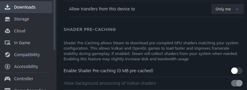

I don't see it in the log either. I'd give the impermanent command a try anyway since it can't hurt ( sudo sysctl kernel.split_lock_mitigate=0), but given what you just mentioned about CPU usage, another thought comes to mind. Using system monitor rather than top, when Steam's at very high usage, try expanding it and seeing if there are one or more "fossilize" processes under it. Fossilize is Steam trying to do shader caching in the background. It's conceivable that it's somehow using too many resources, and top finding it at high utilization while other tools don't kind of makes me think of that. It could also explain why your games are fine. Steam doesn't do this while games are running.
If this is the problem, you can disable it in Steam:
You may only need to disable "Allow background processing of Vulkan shaders." I've chosen to disable it completely because of another, unrelated Steam bug.
