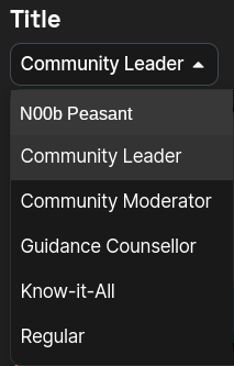

@Aravisian and @337harvey is it here I throw a "n00b" comment?
Does it come with pitchfork ? I would love to have one that says Artist on it.
I had to look up what it is...
