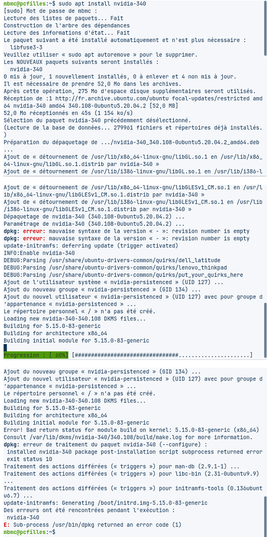

So I tried to reinstall the nvidia driver with the @Aravisian Aravisian method but there is an error at the first step, I'm not sure I should continue? :
EDIT: after that, settings won't open anymore and steam not at all. I rebooted and I was back on screen oh-no-something-has-gone-wrong.
I resolved the issue again with the same fix:

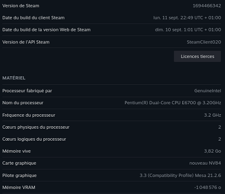

I tried to launch Steam, same issue, then I tried again: it launch and all my games and settings are still here!
If it can be useful, this is Steam information screen now it works:
If it continues to work, I think I prefer to stay like that, not try to install again nvidia-340 and keep the actual kernel. I think I can live without VDPAU in Kodi for the moment, and I don't know if the nvidia driver would be better for games in Steam compared to the xorg one.
