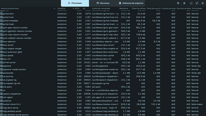

In the last few months I have had problems with audio instability on my desktop using Zorin OS 17.2. I searched the forum and found some tips. I tried using the terminal to use commands to replace PulseAudio with Pipewire, but it didn't work and I was left without audio. After searching the web, I managed to return to PulseAudio and, despite having a slight improvement in stability in the latest updates, I can see Pipewire processes in the system monitor. Every time I use the PCXS2 emulator, the audio becomes very low after closing the emulator. Can you help me with this so I can just use Pipewire? The current server used is pointed to PulseAudio

There have been issues with another user reporting issues with trying to replace Pulse Audio with Pipewire. I can see from your screenshot that it is running but it might be conflicting with Pulse Audio.

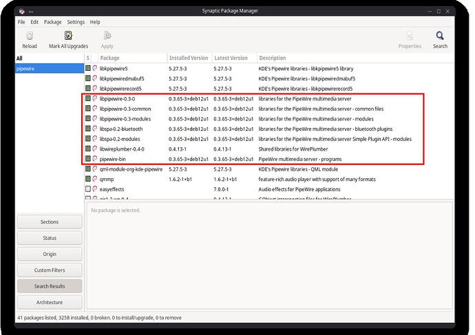

Now, make sure you have the following pipewire packages installed using Synaptic Package Manager. If you haven't installed it, do so now - it is in Software.

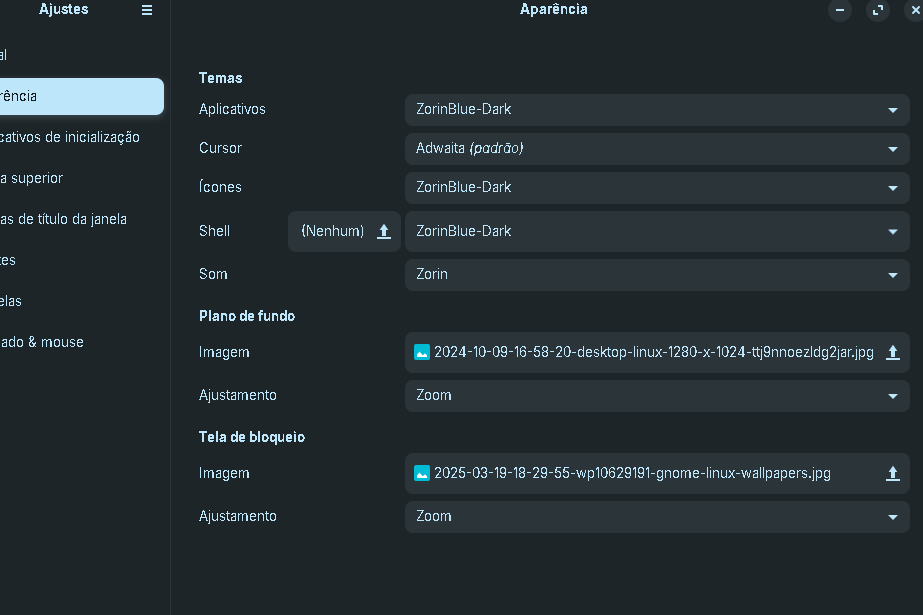

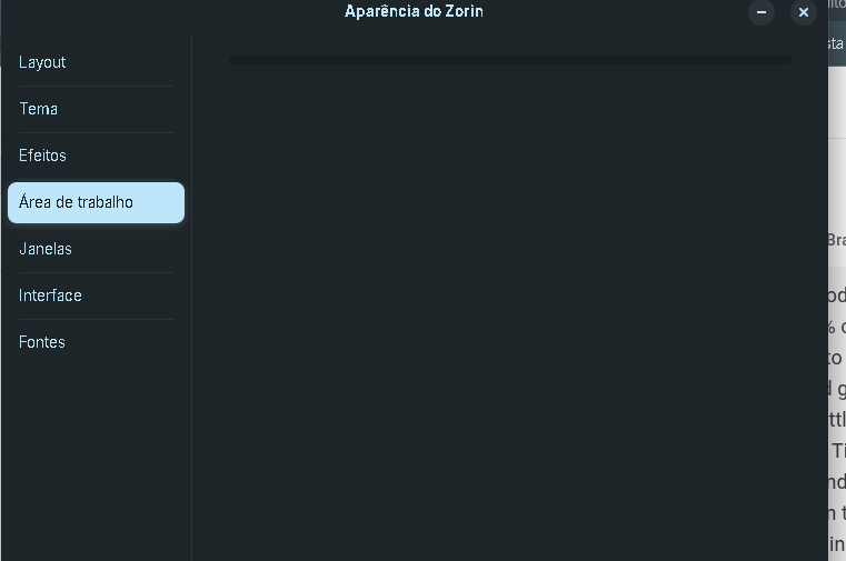

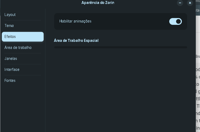

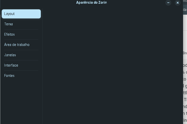

However, I ended up doing something wrong... After the process was finished, I ran the command "sudo apt autoremove" and typed y without reading everything that was going to be removed. I saw that it listed some files with the name gnome and zorin and I was careless. When I rebooted the system, there was only text mode. I was able to log in in text mode and everything was there except the graphical interface! I searched and then ran the command "sudo apt install gnome". After downloading and installing, I was left with pure gnome 43.9. I installed the extension manager and "Dash to panel" to get the task bar. Although some screen freezes that used to occur have disappeared, I have lost all functionality of the Zorin shell. How can I reinstall the Zorin shell, remembering that Timeshift did not work?
Try

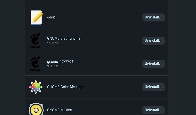

It worked, my friend, thank you very much! After restarting, I had duplicate task bar and desktop icons. So I uninstalled the "Dash to panel and Icons Neon" extensions, as well as the Gnome extension manager. Looking at the "Programs" store application, a new Gnome runtime has been added. Go to the image and should I uninstall any of them?
Runtimes may be used by Flatpak packages as well, so will show as different version numbers. I would refrain from removing them unless you demonstrate that they truly are superfluous.
