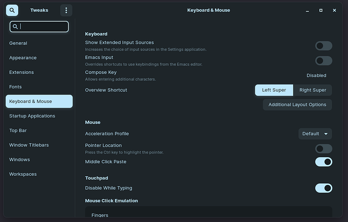

Hi I'm pretty new to Linux, but I'm really struggling with the function middle mouse click paste since I paste my passwords all over the place. I tried using gnome tweaks, but the setting doesn't seem to work at all. I've tried various methods online but mostly cant use them since my lack of knowledge of linux. After searching the web for the past two hours, I've found the following script to work pretty well:

Selecting the middle click paste in Tweaks should actually work, does with me.
Honestly not sure at, why it doesn't work with you.

Im also not really sure why gnome tweaks doesnt work but there seem to be other people with the same issue. Im used to pasting with ctrl+v hence why I have opened this thread. I use ctrl+v all the time but never middle mouse paste because I use it for scrolling. Its really irritating pasting all my clipboard stuff all over the place so this is why I want to remove this function of it specifically.
