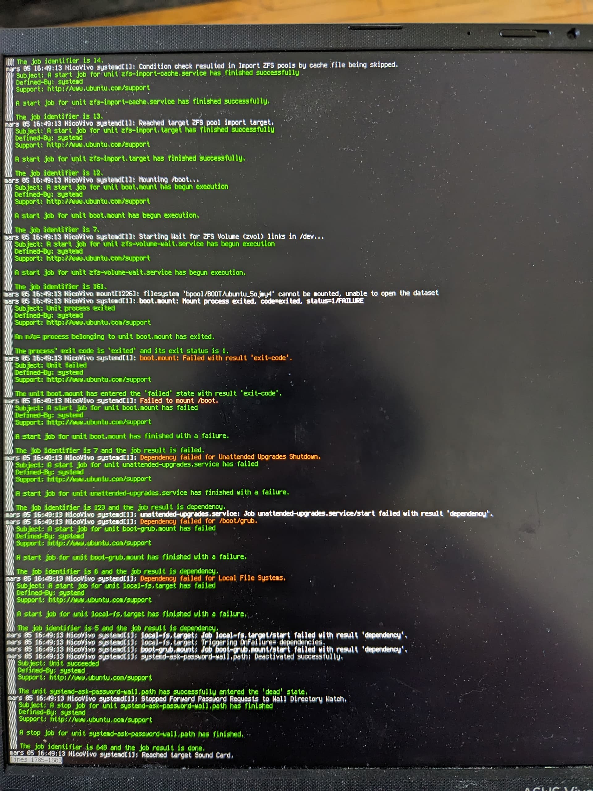

So after trying to boot once it said some error message about failing to load some Network stuff (unfortunately I don't remember the exact message)
And after forcing reboot, after decrypting the partition, instead of booting normally I got the following message: 'You are in emergency mode. After logging in, type "journalctl -xb" to view system logs, "systemctl reboot" to reboot, "systemctl default" or "exit" to boot into default mode". Press Enter for maintenance'
So I tried many things, such as manually running fsck for all mounting points listed in /etc/fstab after identifying them using blkid.
I also tried commenting out certain lines in /etc/fstab doing a sudo nano as advised on some threads with no more success.
Interestingly, after I modify /etc/fstab using nano the reboot command does nothing and if I run exit I get "Failed to start default target: Transaction for.graphical.target/start is destructive" and then I have to force reboot ro get back to emergency mode.
Naturally I looked at the hundreds of lines generated by journalctl -xb and it did not help me understand what's going on. Here are a few screens:
Do You have Secure Boot and Fast Boot in BIOS turned off? And for the Case, You have a Dual-Boot System: Is Fast Start-Up in Windows turned off?
Yup both are turned off. I don't have a dual boot, only linux

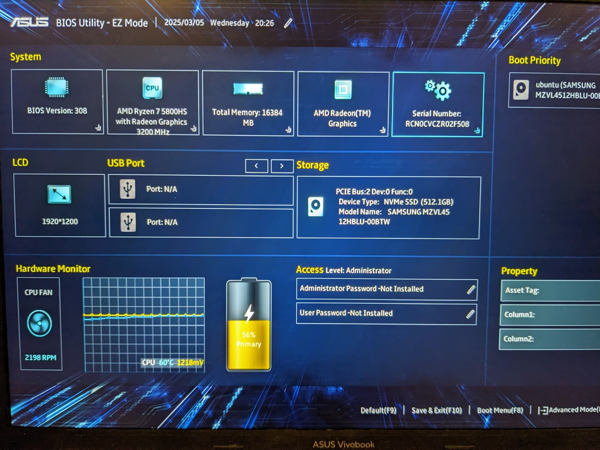

Do you have any information on the system itself? A model number with specifics, or even just cpu, ram, hard drive etc. I know you've got an NVME in there, but it's difficult to know everything. Also gpu etc etc.
I notice there's a line in there that isn't highlighted stating that it can't access something, you might be running a broken bios. I doubt this is the case if you previously recently had windows running properly, but it makes me curious as to what system this is and what specs we're looking at.
Those are my specs.
Yes I saw the line saying I may have a broken bios, and I also think it's not the case (effectively I had windows running on it before installing Zorin)
Ok, I've got a very similar notebook to you then, and I also have a fair few issues with it. First thing I would ask is if you have tried another distribution with a newer kernel than Zorin (such as popos 22.04 / mx linux / ubuntu 24.04.2)? My laptop really does not like the kernels that Zorin has been using, so I have to use manually installed ones if I decided to go the Zorin route on it.

I notice you have a Samsung notebook. They never provide updates from experience and that could be the issue, based on other posters on this forum.
It is an Asus notebook
My bad - was looking at hard drive name! Oops!
