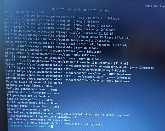

After the sudo apt update && sudo apt upgrade This is what appeared:

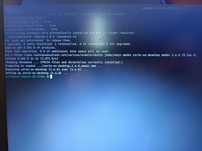

If you reinstall the desktop and then reboot:
maybe all will revert to normal, again.
Is it finished or no? im confused
Yep, the command ran successfully. Can you reboot and test?
unfortunately, still the same
