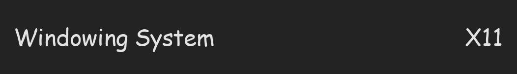

Because You are using a Nvidia Card: Does Your System run in Wayland or X11? You can check that in Settings>About. When it is in Wayland, I would recomment to switch to X11/Xorg because it works on zorin 17 better with Nvidia Graphics.

Does Your System run in Wayland or X11? -Yes it's X11
