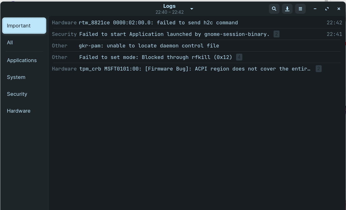

Well, let's get to the point. I have HP PAVILION 15-CW1001NT. Since the computer was designed for Windows 10, I had no problems using Windows. However, when I started trying Linux Distributions to explore the open source and Linux world, I ran into a problem. Out of nowhere, it suddenly freezes/becomes unresponsive and doesn't get better without rebooting.
Here are the errors I get:
You might try:
sudo nano /etc/default/grub
Find the line: GRUB_CMDLINE_LINUX_DEFAULT="quiet splash" and add acpi_backlight=video after quiet splash so that it looks like:
GRUB_CMDLINE_LINUX_DEFAULT="quiet splash acpi_backlight=video"
Tap ctrl+x to exit, then the y key to say yes to save, then the enter key to save as current configuration.
The terminal will revert to normal. Now, run
sudo update-grub
Reboot and test.
If the above does not work, try changing it to:
GRUB_CMDLINE_LINUX_DEFAULT="quiet splash acpi_backlight=vendor"
Exit and save, then sudo update-grub && sudo reboot and test...
