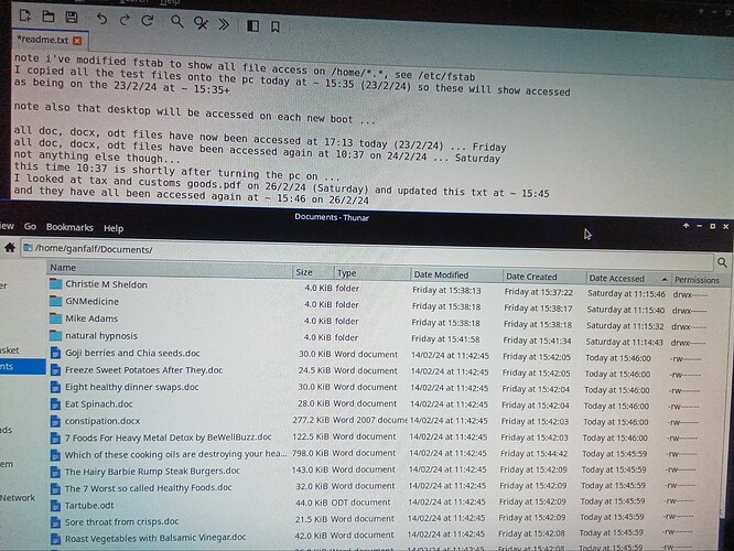

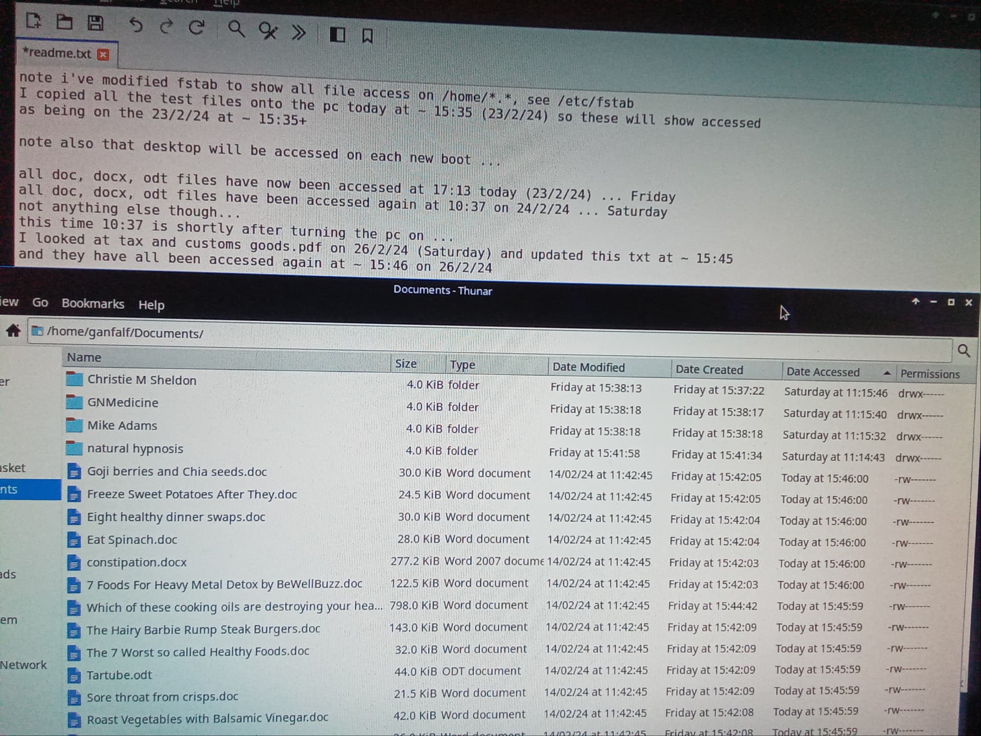

The final update....

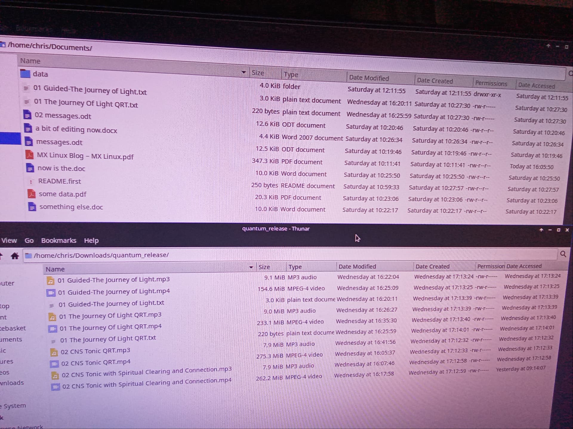

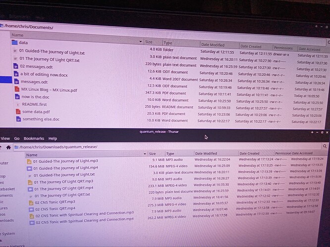

There is attached two photos. infected pc and clean pc.
These are both new builds with only one change on both of them, see below. Therefore they are identical, all setting the same, default settings with the exception of thunar as I want to see quickly if files are accessed.
The infected PC is not connected to the new router. It has no internet access now.
Notice that on the infected PC, the doc, docx, odt have all been accessed, with different times to the created time note also that the accessed times are the same within a minute or so and also read the text in the photo of the infected pc, as this gives more details.
Now bearing this in mind, notice that on the clean pc, there is only two files that have been accessed and it was me that accessed them both.
So this clearly proves that access time has nothing to do with caches or indexing, as I previously said it didn't, as if it did both PCs would behave identically, considering they are set up identically.
Further this also clearly proves that there is something going on differently between the two PCs and this is highly likely be an infection, as the two PCs are set up identically from an official download of an install DVD.
I had reset all the SSDs with hdparm prior to the new install, so it's most likely that something has infected the bios or some other firmware of the infected PC, which was the same as the old scrapped one, again see below.
For the reason I am making this post it is totally irrelevant how the infection occured, this is only about how I noticed it.
There are various types of file on both the PCs, so that a fair comparison can be made between the two.

The photo of infected pc attached is from the second infected pc.
