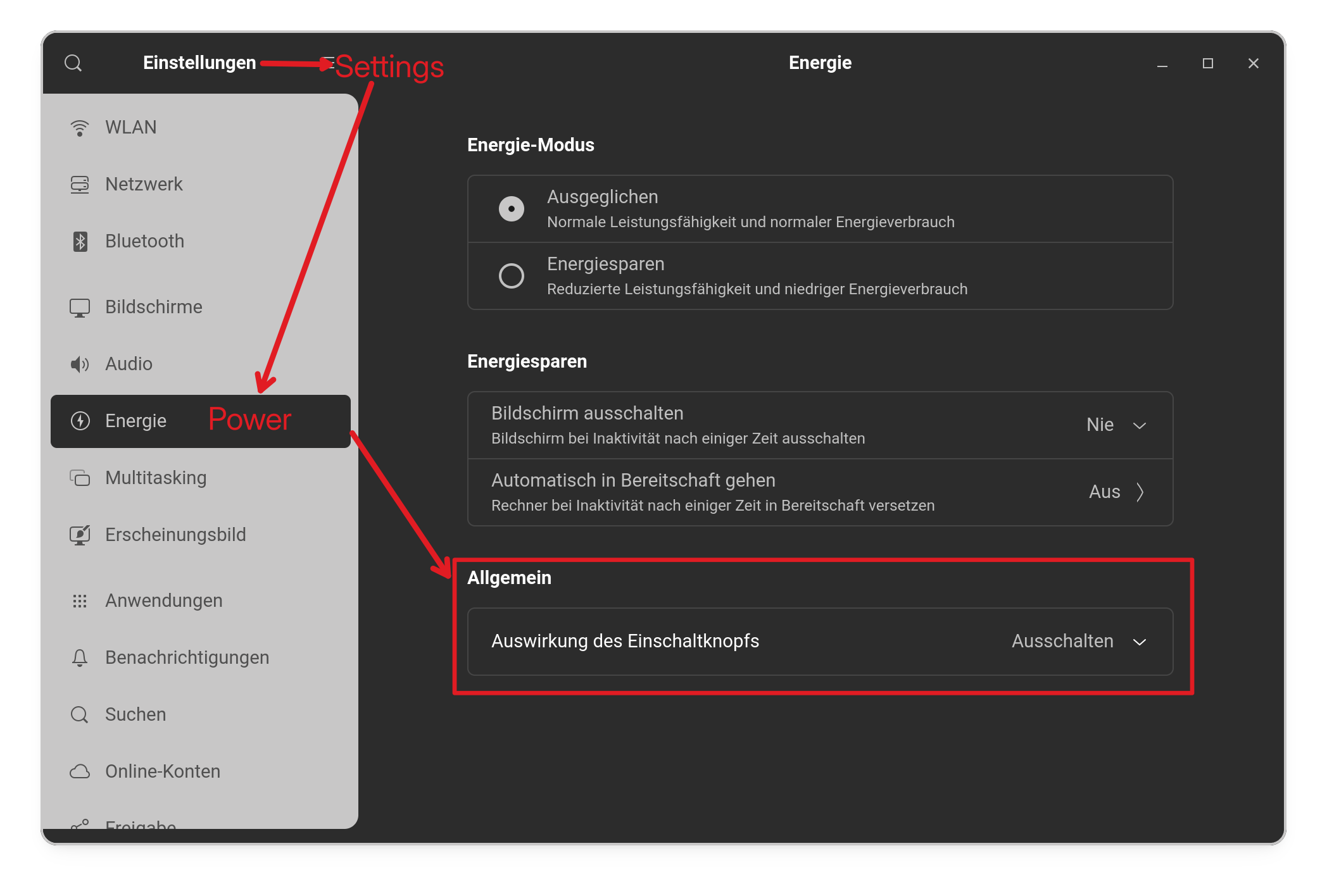

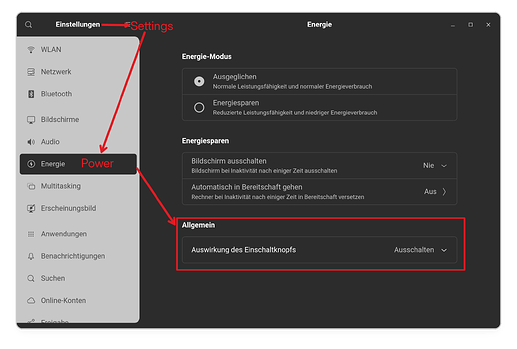

Check in Settings>Power the Behavior of the Power Button.

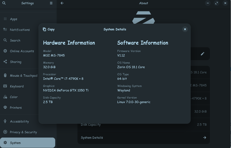

[BUG REPORT] Kernel 7.0.0-30 Update — Suspend Freeze + Erroneous fstab Entry
System: Zorin OS 18.1, dual boot with Windows 7 (offline), MSI Z87-GD65, Intel i7-4790K, NVIDIA GTX 1050 Ti
Update date: August 21, 2026 — kernel 7.0.0-30.30~24.04.1
Issue 1: Suspend freeze
After installing the update, suspend no longer works correctly. The screen goes off but the system locks up completely — CPU fan spins up and the machine stops responding to keyboard and mouse entirely. Hard reset required every time.
