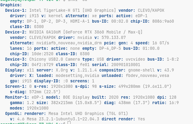

It may be a driver issue(s).
Let's see;
sudo apt install inxi
inxi -Ga

I see, You are using a Nvidia 3060 Graphics. That You are on Xorg ist good. You shouldn't change that. You could try it with a different Driver. To switch open the Terminal and type:
sudo apt purge nvidia*
to uninstall the current Nvidia Driver. To install a new Driver type:
sudo apt install nvidia-driver-[Version-Number] nvidia-dkms-[Version-Number]
For [Version-Number] use the Number of the Nvidia Driver. For Example 550 or 535 and then it would be look like this:
sudo apt install nvidia-driver-550 nvidia-dkms-550
Repeat these Steps to try it with different Drivers.
